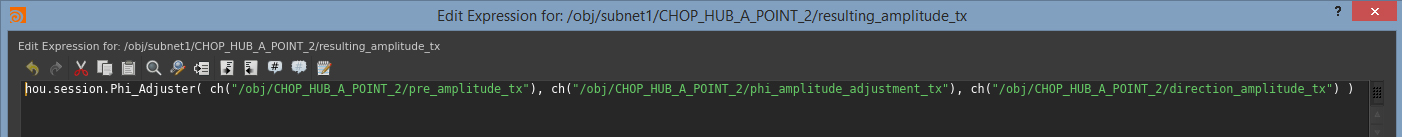

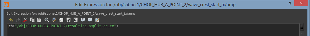

Hi graham:
No I wasn't using relative paths, only “channel reference” option as opposed to “Relative channel reference”
I'm including a few screenshots…one of the error messages and the others that refer to the error message. There are more references in the “chain” of channel referencing but they all refer in the same manner with “channel reference” and the functions are all prefixed with hou.session.
Thanks
