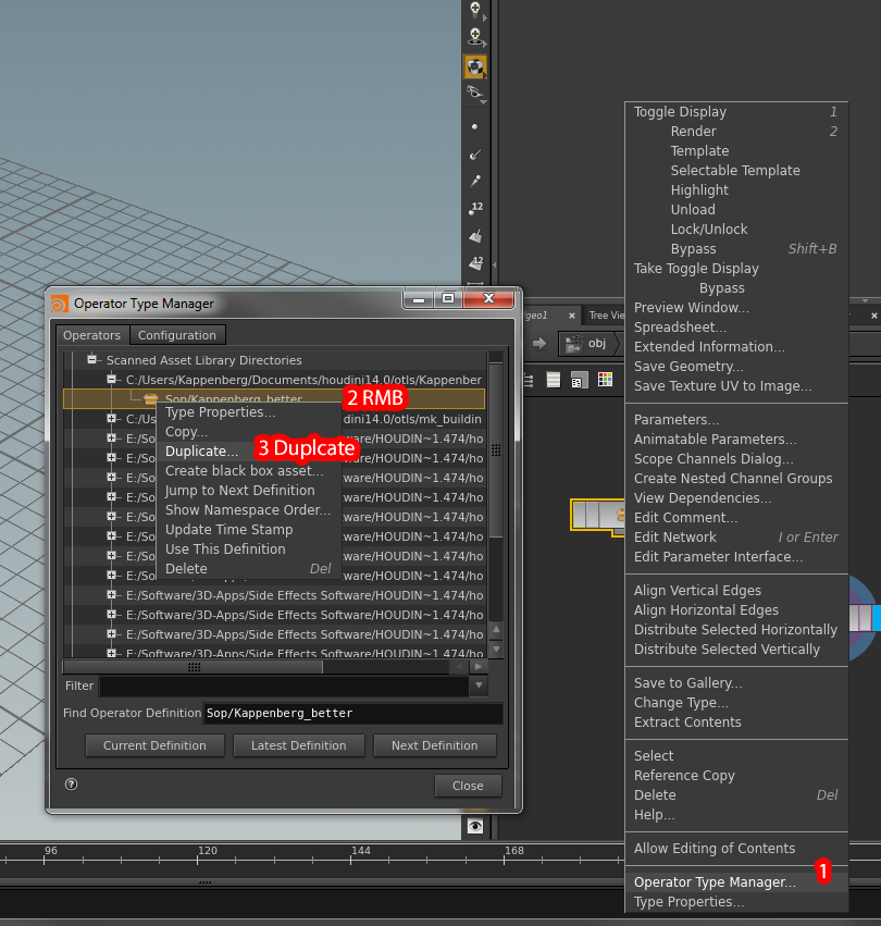

Try “Operator Type Manager” from the RightMouseButton Menu on the HDA.
(Right above “Type Properties”)
Then duplikate yout tool and set a new name.
Save everything and restart Houdini.
Insert your HDA again and go to Operator Type Manager again. Now delete the “wrong named” HDA.
This was the only solution I found after fiddling with the same problem.
If there is a better way, I'm interested, too :-)

http://www.sidefx.com/docs/houdini/hom/hou/HDADefinition.html [www.sidefx.com]
there is copyToHDAFile() function so you can automatize the process over a lot of assets
