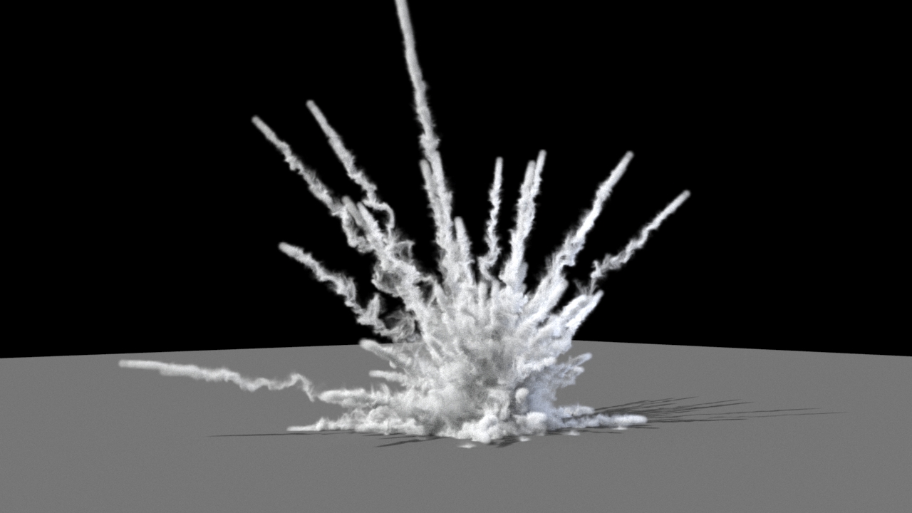

I think your getting far to complex. RBD > pieces > emit particles > turn to volume . All the rbd chunks need on them is a noise shader to eat away at the diffuse / alpha .
Rob

Hey Rob!
I have done some testing and yeah. I think I've been overcomplicating it.
Here is a test I did yesterday.
This is sourced used particles, but I'm going to do an RBD sim instead so I can get more variation in size, while having more interesting shapes. And then use particles to add more grains in some areas.
It's getting there, but still loads to do!
All the best,
Audun

unless you have pieces becoming bigger than the 20% of the screen space, I would literally scale them to 0, and use their area to emit points. bazillions of them, you should also wedge the particle pass
