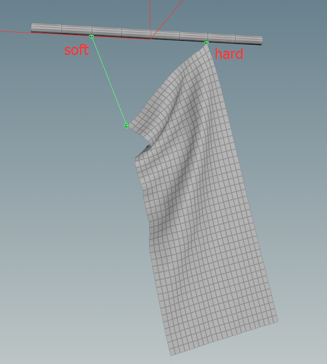

the soft type in cloth stitch constraint is not working.
this problem is not happend at houdini 13, but, since houdini 14, it was a big problem.
am i do something wrong?
someone help! cloth stitch constraint got problem.

Hi , I have exactly the same issue with houdini 16. No matter how high the stiffness, these constraints seems to have no effect at all.
It says in the docs that, contrary to the “hard” option, the “soft” option create forces “instead” of constraints, but I can't find any information about these forces in the dop network spreadsheet.
