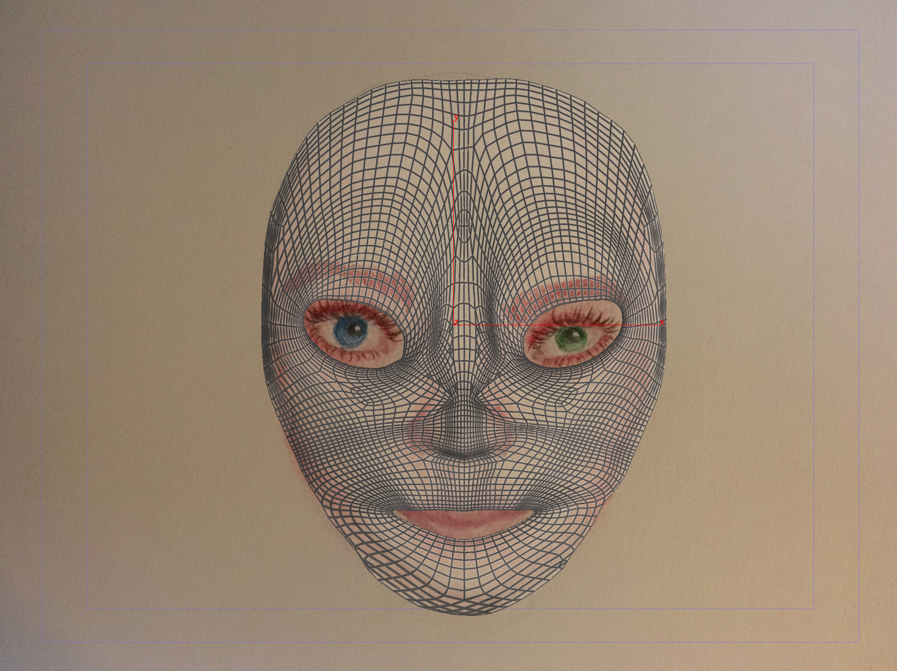

Did you know Houdini can now do facial recognition dynamic scanning edge detection that runs off GPUs and then turn that into geometry? Here is an example of what Houdini can do now in the attached image that was originally drawn by hand, imported into Houdini and scanned using a new mathematica Houdini node. I changed the algorithm today based upon feedback and requirements asked for by DASD. I also changed the algorithm to use as many images as one cares to use and automatically subdivide based on modeling and animation requirements, based on DASD feedback.
See attached multiple pass, multiple resolution facial edge detection image samples. Wrinkles, no problem.
More information here: http://fvg.com/technology.html [fvg.com]
Unfortunately generating a billion polygons as DASD suggested was done broke the mesh somewhere on the round trip from Houdini to Mathematica and back again, so I have to fix a bug in my Mathematica code or adjust the code so Houdini can handle the polygon count before I upload a Houdini screen shot. I still have some work to do. Time for my milk and cookies. I will automate Houdini UV creation for multiple geometries as per DASD request using Heat Seeker algorithm.

Just a progress update. Using the automation technology I am developing that is connected to and drives Houdini I am now able to generate a mesh with good detail from a single image. This took ten seconds to generate from the drawn image. I still have a lot to do but progress is very good. Link that discusses technology I am developing is here: http://fvg.com/technology.html [fvg.com]
