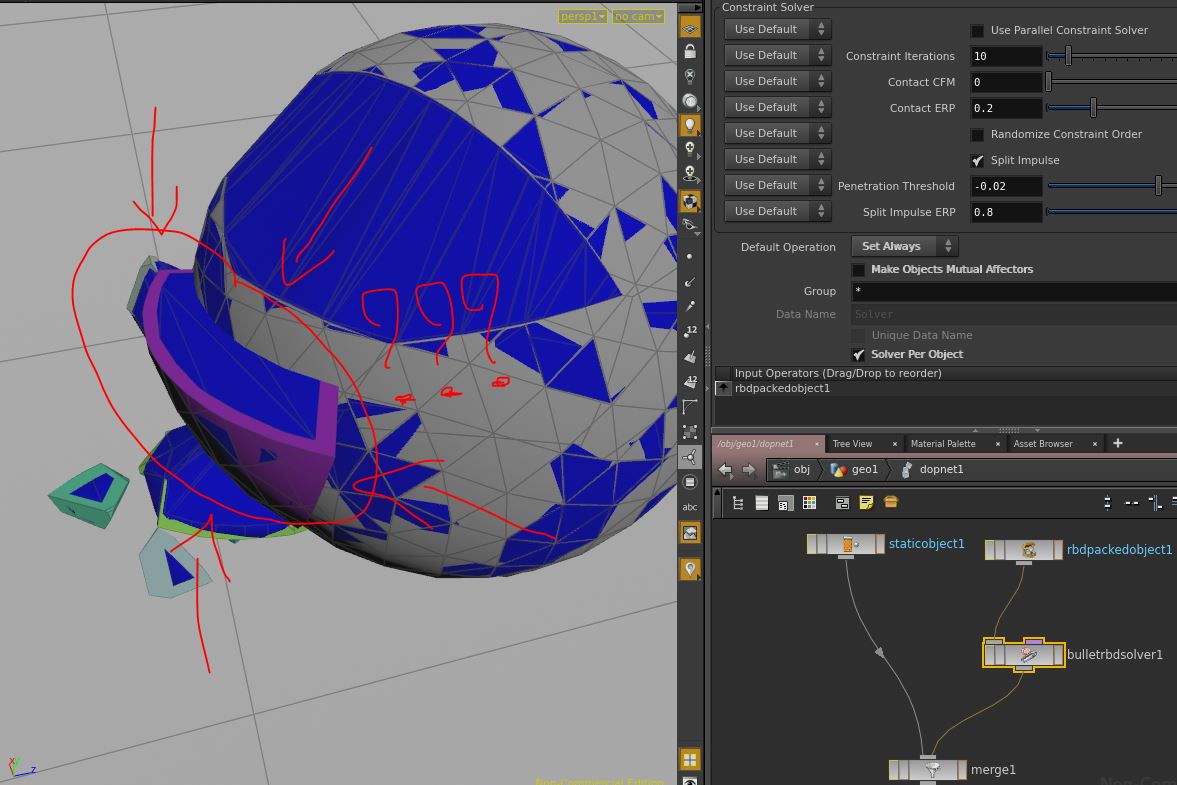

Hello.
Simulating these types of simulations always been a challenge!
Most of RBD engines use similar methods for reducing sim time hence sometimes and in some simulations we dealing with penetration.
Bullet engine has convex hull geometry representation in which objects has convex hull shape around of themselves.
you can use Houdini native RBD engine it's precise but takes much longer to calculate.
If you insist on using Bullet, you have to choose concave geo representation or implement a little bit tricky method like following HIP file.
Thanks.
Thanks.

HI NimaNolan,
thank you for your message… and yes! is always a big challenge with rigid body sim in all software.
So native Houdini RBD Solver is “rigid body solver” with type “solver engine RBD” ?
I see by default is Bullet so I use a bullet solver alone, but try to understand your file
- ok, you separate fracture/debris to other part.
- why you use “unpack” before the “for each” ? Because I use “assemble” node with the check on “create packed geometry”… (?) maybe you did that for create a centroid expression and center the pivot in the center of all objects right?
- why you need a create another voronoi fracture on the second element?
Can I use it in one-block without another voronoi node?
Thank you for your time, I will only understan and I know maybe my question is more long….
Matteo
yes, exactly.
Your geo representation set to convex hull which means holes of sphere ignored by bullet solver(as we can see in your image) and this is why fractured pieces penetrate each other!
I created centroid expression to make pieces a little bit smaller around pivot point of each object(just for sure that we not getting any penetration).
I use another voronoi fracture node for geo representation Correction see following picture.
Of course you can do it with one voronoi fracture node but in bullet geo representation you have to choose concave(but concave makes your sim unstable and slow).
cheers.
