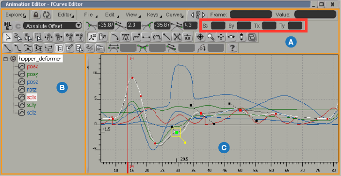

Here's an image with XSI's animation editor.
I was thinking about doing some .gifs, but I think it's pretty clear from this image regarding having access to all the things you need (tangents, etc) when you select a key - no need to select several elements, separately, from the same key.
In the left side, as is with most if not all XSI's editor, you have a set of detailed preferences attached to this particular editor. So you can easily find and customize shit.

McNistorHey McNistor you miss the transform tools on you screenshot.(right clic on an empty zone on the UI to add them)
Here's an image with XSI's animation editor….
Thoses are VERY important.
