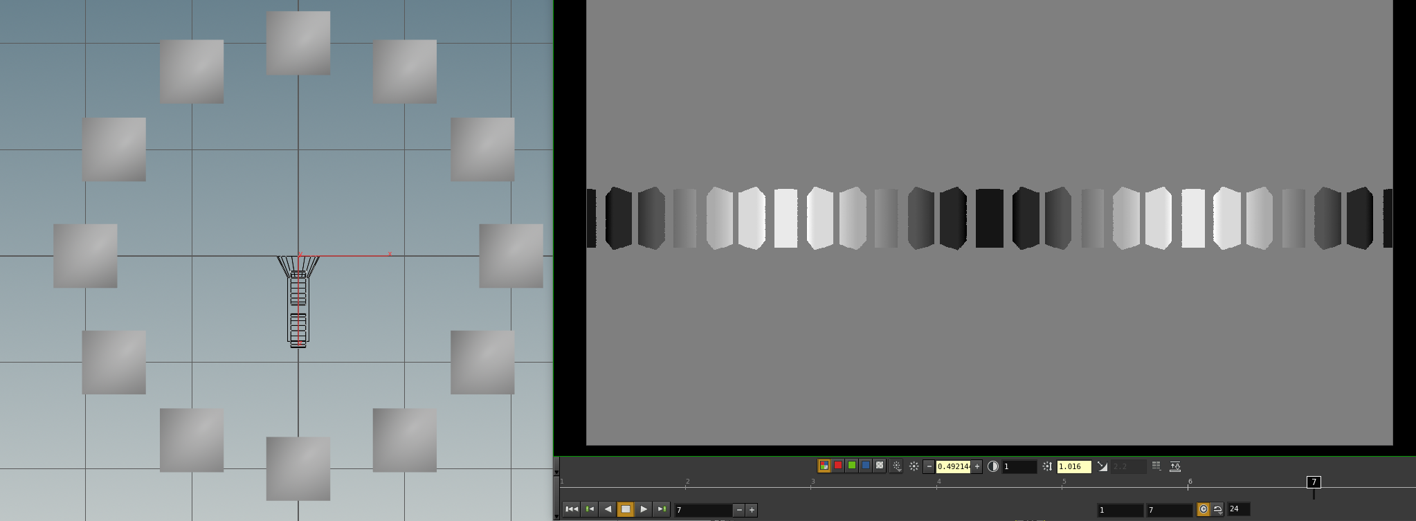

I try to render a depth map Pz with the VR Camera and i get this result :
I wonder if it is possible to have more option like the Octane Spherical (equidistant) Camera ?
For the project i am working on, i need a specific FOV (like 180*30 deg), and i don't know where i can change this values on the code.
In attachement a screen shot of octane camera option for VR, and my depth map.
Cheers

Hmm, doesn't look like you can modify the camera like that, you might have to RFE, or assuming the VR camera has been written as a lens shader, modify the code yourself.
Re the depth being wrong, you can define your own z channel by measuring the distance from Eye to P, and exporting that as an extra image plane.

Thanks for the feedback on the VR Camera. We currently don't support partial lat-long renders with the camera, though this control could be added. This will be added on Monday, ready in the next daily build of H15.5.
For Z-depth output you should be able to shade using ‘length(P - Eye)’, but I will need to confirm this. I will let you know shortly.

I've made the changes to the VR lens shader and attached the updated code here. The VR camera is a bit more involved, but the update will be available in the next daily build of Houdini 15.5. Please let us know if you have a chance to test out the new feature. Thank you.

WOW, i just try, and it works like charm.
You just open the door of every planetariums ! Now they can render at 360*210, they like this ratio
