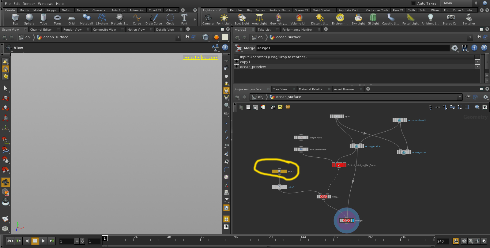

Hello, can you please tell me which version of houdini you used to create the project file above?
I tried opening with 13, the file opens but it gives a list of WARNINGS.
This is what I see after closing the warning popup. (check img bellow.)
I tried replacing the BOAT (sphere) with other objects, then simulate but nothing happens..
Edited by aguha2050 - July 12, 2016 03:46:19
7 posts
Joined: July 2016
Hello anyone? plz
2185 posts
Joined: Sept. 2015
I'm using 15.5.480
Works fine for me.
Only warning is on last node with “mismatch of attributes”, but that can be taken care of easily and shouldn't affect the sim.
7 posts
Joined: July 2016
I tried from a latest version of Houdini and it's working.
thanks both of you for helping.
