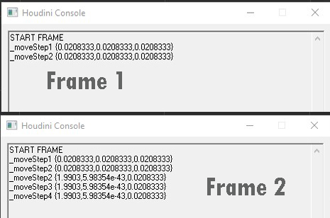

After implementing this I came up with a new issue, wich is not realated to this last change.
So if you take a look into the code you will see what Im trying to do:
-On frame 1 I record the position of the target, wich is the blue point you can see in the 2nd screenshot, and I also calculate what I have called _moveStep, wich basically given an amount of frames, this should be the amount wich the sphere has to move on each frame, to reach the target in that amount of frames.
-Then for every next frame (if @Frame > 1) I do the check and then move along the Dir Vector (vector pointing to the target), wich you can see in the 2nd screenshot too (the red one).
The problem here is that _moveSteps changes in future frames even if I calculate it only on Frame 1.
In the 3rd frame you can see the result of all the printf I wrote to check where the varaible was being modified, and again, for some reason it changes even if I calculate it only on Frame 1.

The way you set it up
_moveStep will never get a value after frame 1
coz that variable is only exist on that particular point wrangle
thats why if you look at your snapshot once it get to frame 2 the value no longer 1/48 ( which is 0.0208333)
instead it get whats in the memory at that pointer variable which some random number
as usual here i attached the fix…
