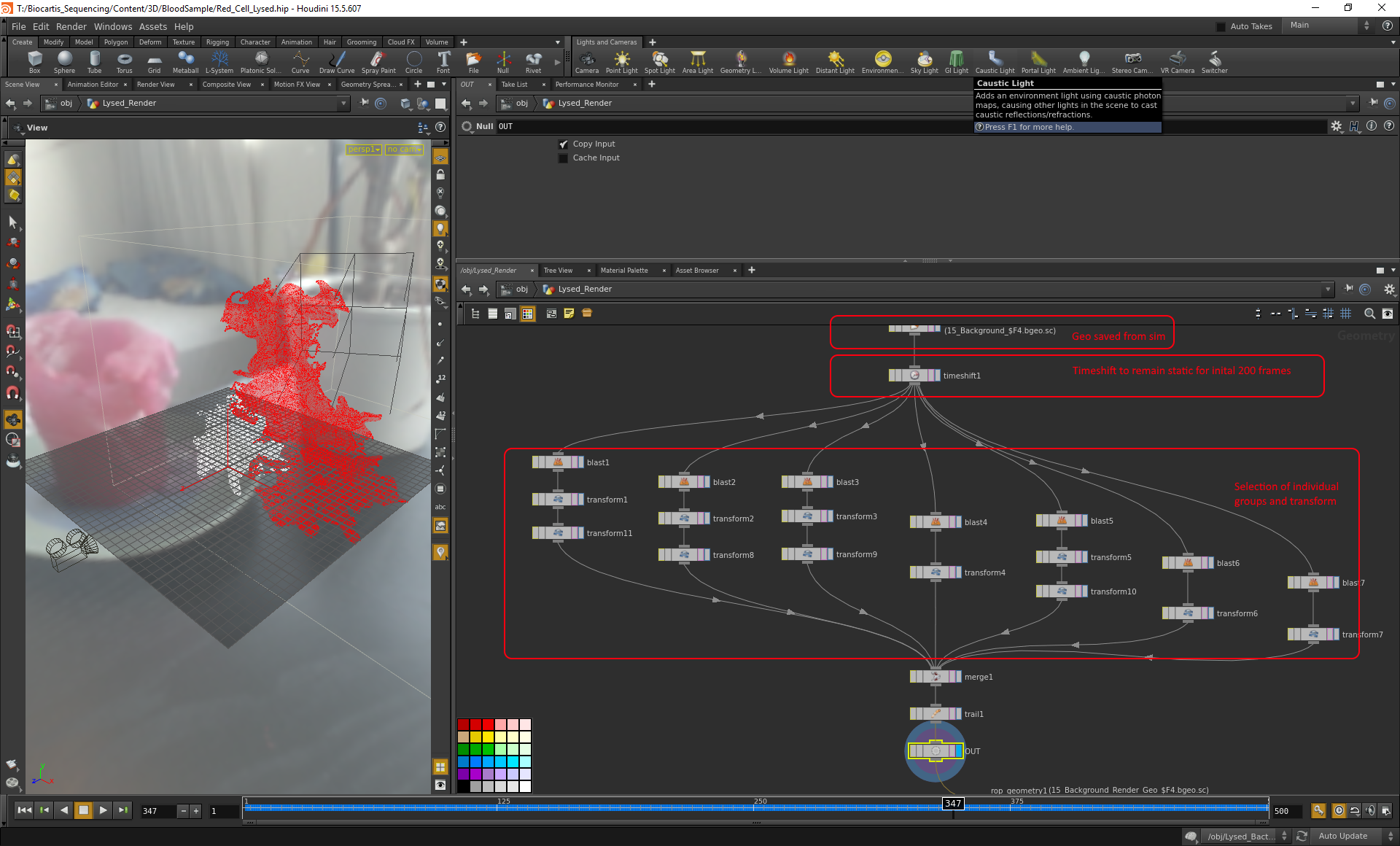

That certainly does reduce the ifd size, yes. However, here's an example of the kind of problems I'm having…
I saved out a bunch of geometry in one geo file that contains groups. It was a particle simulation…sort of that lasted about 250 frames. My final animation requires that simulation to start at about frame 200, making the whole length 450 frames. I also wanted to displace things slightly based on groups, so I cannot load it as a packed primitive. So from what I've learn it seems I have no choice but to write out another sequence of geo files costing another 30gb and time
I've attached an imagine in case my ramblings above were incoherent.
So…was there no way to do this without writing out geo again for every one of the 450 frames?

You are correct, you'll have to write out your geometry as a final step. Note that if you don't, you're still essentially writing out your geo into IFD files anyway so it's not like you're saving disk space. What I would do is use a delayed-load procedural right after the file cache node and your IFD-gen should be very fast because they'll contain links to the geometry on disk rather than containing the geometry itself. I'm not sure what the advantage of using packed primitives are, but delayed load procedural works very well in our pipeline

Hmm, I must have done something wrong as I tried that before. If I check the ‘delay load geometry’ on the file SOP shown in the previous image then the geo is just written to the IFD. Unless that's expected behaviour in that situation?
Edit: I've just looked into delay load procedural and all I can find is this: https://www.sidefx.com/docs/houdini14.0/nodes/shop/vm_geo_file [sidefx.com]
Which appears to be a shader. And now I'm just confused.

That's correct, it's a shader inside a shopnet. We use our own OTLs for this so I don't recall the steps to set it up manually but it looks like the help doc will get you going. One note, if you're applying materials inside your geometry context you'll need to write out a material description file and reference that in your delayed load procedural. You'll use a Mantra Archive node in the output context to save a material description into a single IFD file that contains your shader links
