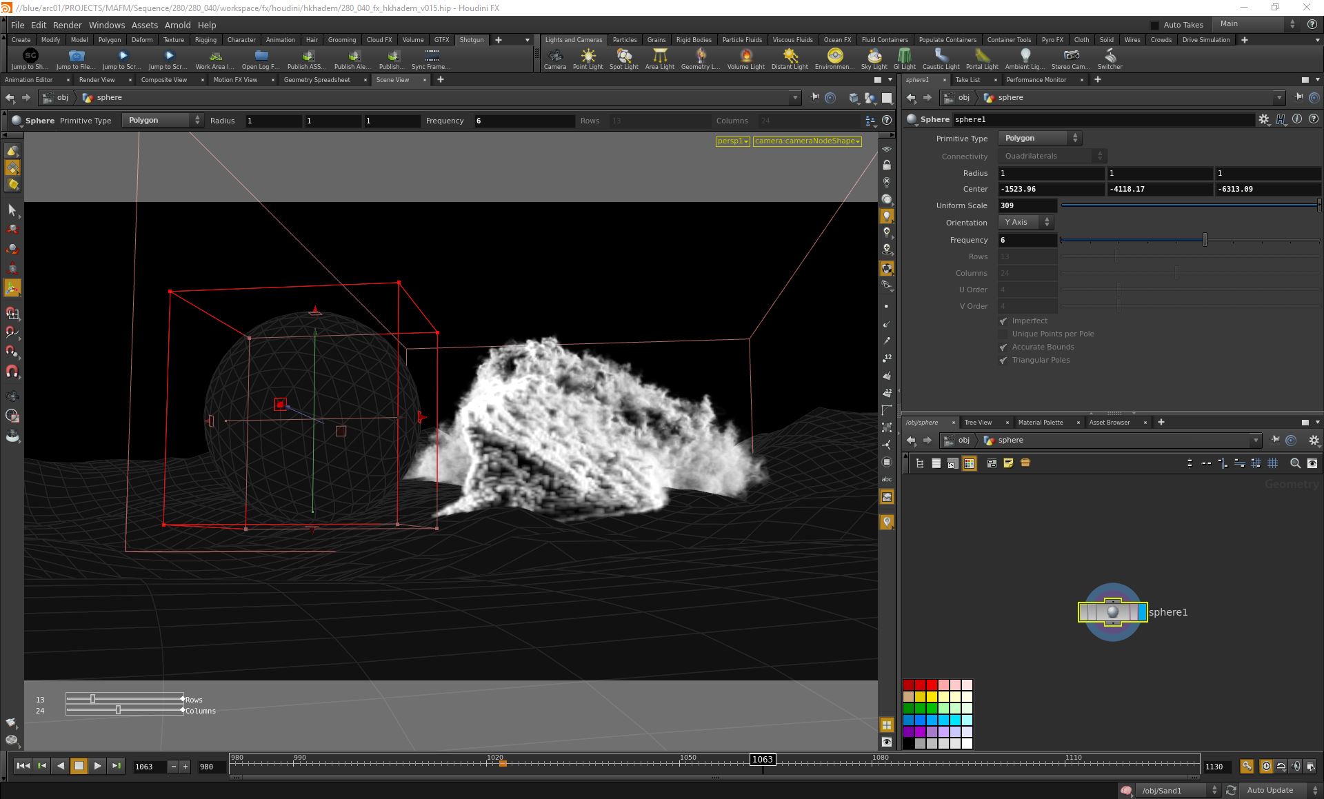

ok. both pics are 2 point lights. First picture attenuation is on and I can see smoke looks good enough but the scene is pretty dark( I had to hid all geos from the scene because of copyright but I put down a sphere to make it more clear)
Second image I turned off attenuation and as a result I had to turn down the density but that screws up my volume. Once it become pure white once it becomes pure black.
