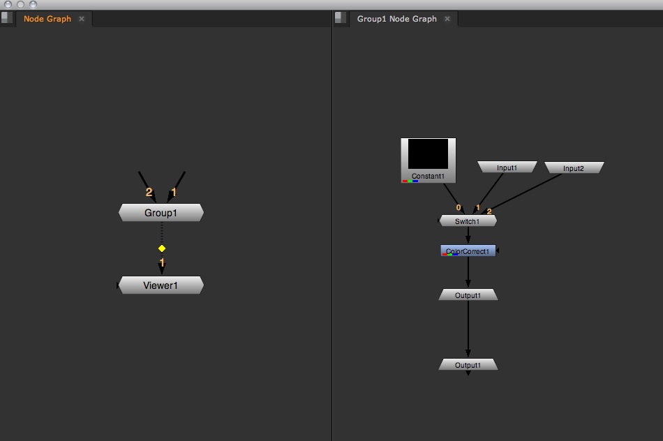

I would like create a custom input for a SOP, like Nuke style input/output in groups.
I attached images to see the concept. I don't know if this is possible do it in Houdini for a SOP, and how to do it.

In the Nuke screenshot, you can see ‘input’ nodes, they are the equivalent that I find in Houdini.
Input node inside a group, in Nuke allow connect inputs from outside the group.
There are something like that in Houdini?

For user can connect a own op. In my current case, to a curve profile it would be expected.

Aaahh, looking at your pictures again, it looks like you think that the output plug of a geometry node is geometry data. So no, as I said those are for parenting, or manipulating the transformation data with other OBJECT LEVEL nodes.
I think what you want is an object merge SOP, just look it up and see what it does.

However, the concept is very simple I think. That is extract a input control from a group to allow user can connect it something to this input without open group and go into this.
In Houdini, a node in object level (geo1 for example), have a one input and one output to do operations in this level.
My question is, it's possible that geo1 have a secondary input (not for parenting) point to custom parameter inside this geo1?
