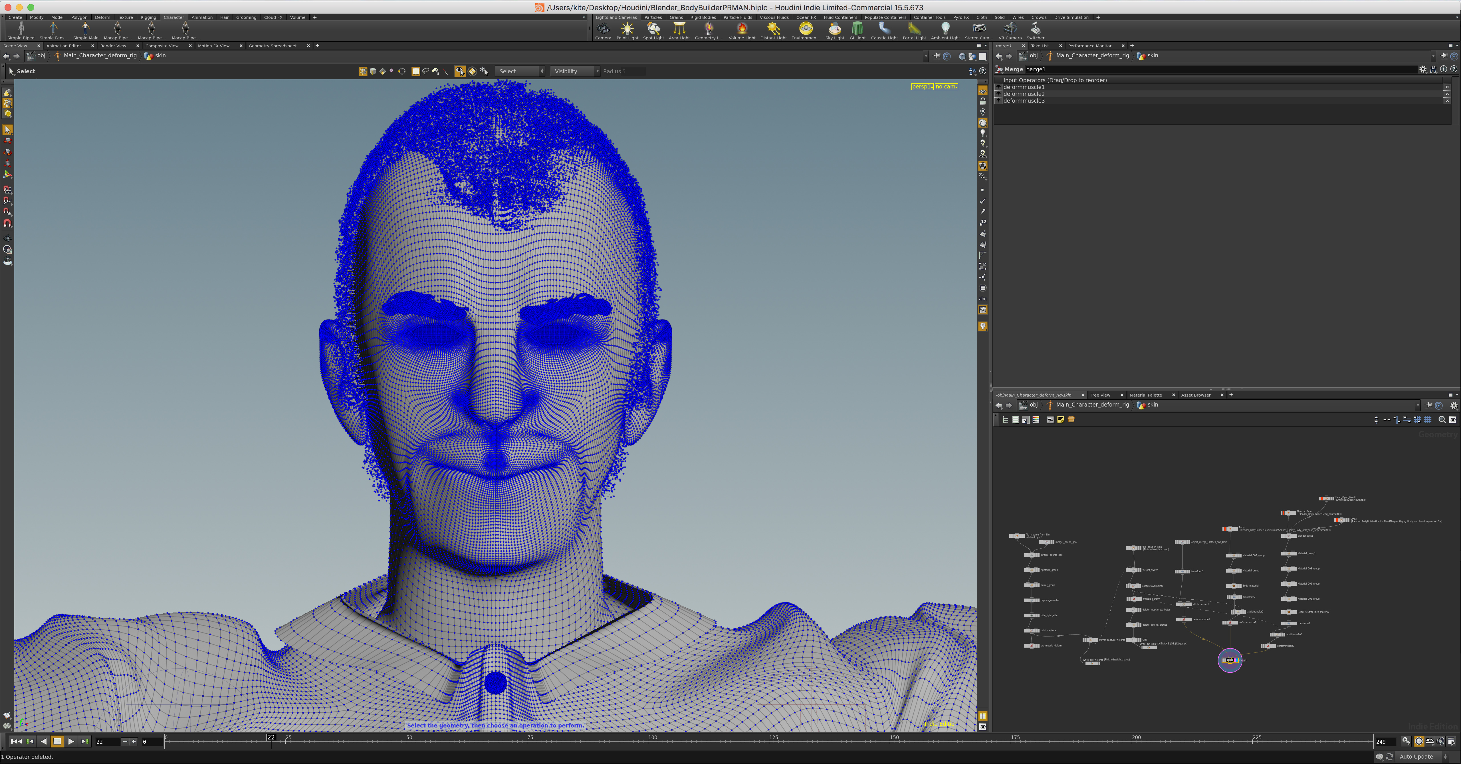

Yes! I was thinking about doing that! but the problem is my character mesh has too many points since it was subdivided in the export…
So right now I am trying to make the faces in Blender(which is the modeling software I use) before the subdivision and then import them as blend shapes to Houdini.
But some of the blend shapes don't work correctly…
I would still love to learn about facial rigging though!(Like muscles) But I can't seem to find any tutorials for Houdini about that…

ALMINA
it looks like you have different point counts on your mesh and the blend shapes.
use the lattice SOP set to Points mode to drive the main mesh's points into the shape, then use sopcreateedit to make the blendshapes into Edits:
http://www.sidefx.com/docs/houdini15.5/commands/sopcreateedit [sidefx.com]

Thank you arctor! I'll try that! and where am I supposed to type in the sopcreateedit command?
Edit: I seem to have trouble using the lattice tool… There are too many points to move. I like using the edit tool with the soft settings on but then it seems to move the teeth as well, which I don't want

read through this thread (wow…from 2009)
http://forums.odforce.net/topic/9136-importing-external-blendshapes/ [forums.odforce.net]
I uploaded a simple setup file there that can get you sorted.
be sure the read the comments on the nodes in that file using the middle mouse button.
might be worth making as HDA to do this…when I have some time
