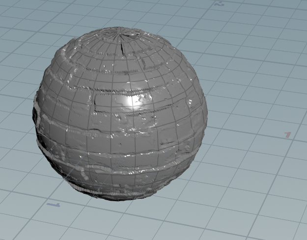

I think this may be something simple, but I don't have the experience to know for sure.
As the title suggests, I'm not getting any displacement showing in the viewport. Also when I use an opengl ROP there's no displacement, which would point to an opengl problem. When I render with Mantra the displacement is correct. I've tried in H15.5 and it has the same problem.
I'm using H16 Indie, Windows 10 and my GFX card is a GTX 960 with 2GB. I've checked for any obvious errors like not having ‘Displacement Map’ selected on ‘Display Materials on Objects’.
Any help much appreciated!

Having the same issues with displacement. In H15.5 it works as expected, but in H16 I cannot get it to work.
Not even a scenefile from H15.5 in H16 will work.
As far as I can tell, something is broken here.

@Artye: Thanks for the scenefile, it was helpful to help me find what was going on here…
Despite using the default example materials (e.g. bricks, woodchips, concrete etc.) Houdini was not giving me displacement in the viewport.
After rechecking all my Display settings, and being sure I had the proper shading model turned on, I found the culprit in the shader settings.
So even for the example materials with displacement, the “Displacement>Custom Input>Enable Input Displacement” was turned off. Checking this box immediately fixed the issue in the viewport.
Not sure if this checkbox is supposed to be turned off by default, or somewhow one of my Houdini settings has changed?
