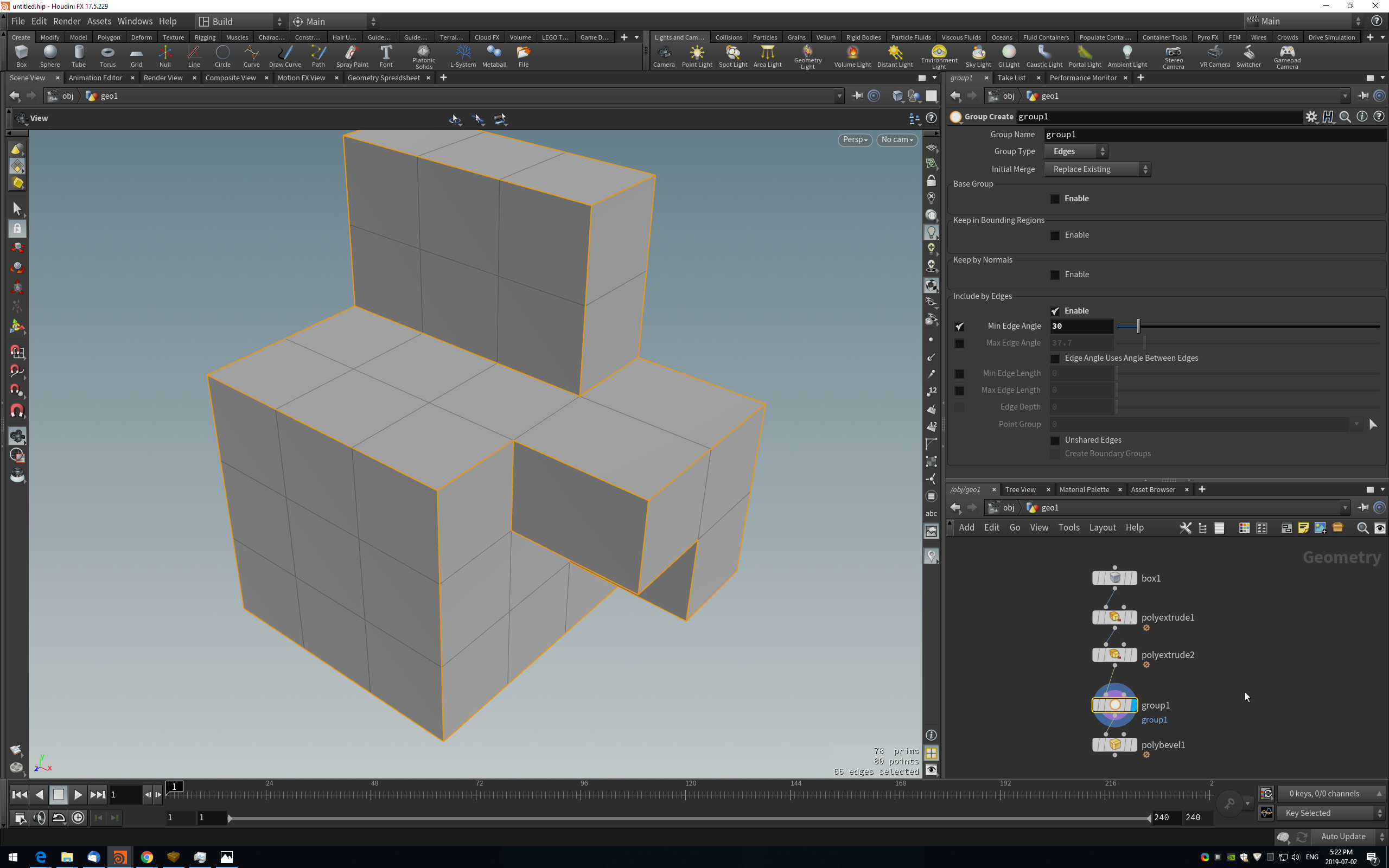

Joined: Oct. 2019
I needed to bevel corner edges on a building - I did mine simply with a group node
I enabled 'Keep By Normals', and set vector Direction to 1,0,1 and Spread Angle tp 0
I enabled 'Include By Edges' and set Min Edge Angle to 1 and Max Edge Angle to 180.
This only selected corner edges, and no flat edges. You could also collapse unneeded edges using this group if needed.
