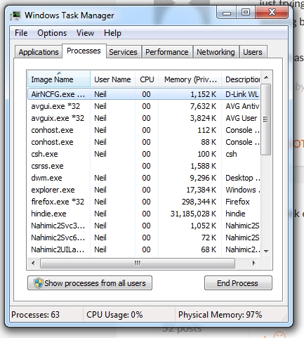

what is your ram usage doing as you render? it could be increasing to the point it puts the render into swap. the dopnets that are cooking during the sim will eat the ram you need to execute the render.
it is generally best practice to bake all sims to disk prior to rendering.

OK will definity do, but I'm finding this mist sim is just totally eating my ram and bogging my system down. Without it I have 22 gigs of usage, with it I'm maxed and my view port grinds to a halt and everything takes forever to even just select. And I'm using a GTX 1080. When I first load Houdini and load the scene with mist the viewport is butter smooth, but when I start working things rapidly start to bog down. I baked the mist sim but even when I click Playback Simulation it still wants to cook out the sim and bog things down… Is 32 gigs just not enough?

In this case I would take a 2-pass approach. Kick out a .bgeo.sc cache from the compression node inside of import_fluid. Then once that is generated, kick out a second pass from the surfacing node file cache. The surface cache is what you will render.
By kicking out the compression first you can simulate a higher quality fluid with the same ram.
