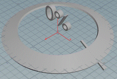

So I have this “percentage loaded” animation in Houdini and it spins counter-clockwise. I export it as alembic. When I bring it into UE4 it spins clockwise.

FIXED: If you look at the image closely, it looks inside out. I tried again today and noticed that the y-axis on initial import looks to be -1. I didn't notice this when I set the scaling to 100 units (to convert 1m units from houdini into 1cm units in UE4). Setting it to -100 now shows the correct animation.
