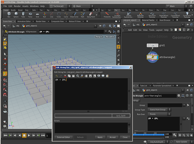

maybe You´ll have to expose the Pointnormals first…

@sebastianvfx: did another example,
maybe it helps.
