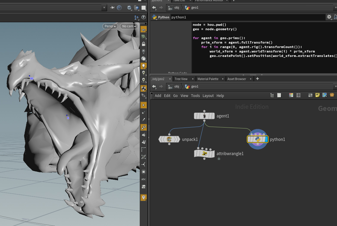

Is there any way to get the location of the shape object for an agent layer? If I could reference that point then I could copy something to it at a specific time.
I spent the morning trying to figure out any way to leverage python and agent layers. But I can't find a single code example on how to even use the built-in python functions for hou.Agent [www.sidefx.com]. I still don't understand why we have new bells and whistles in the graph editor yet there are not examples in the help when you need them..?
I don't think a disk sequence will really work in the case of pyro, due to collision. I would still like the pyro to collide with the area where the dragon agent lands. This may not be an empty space, as shown in my GIF. It could be an area with buildings or non-flat ground plane. This means I need to kick off a pyro simulation when agent reaches a certain state.
