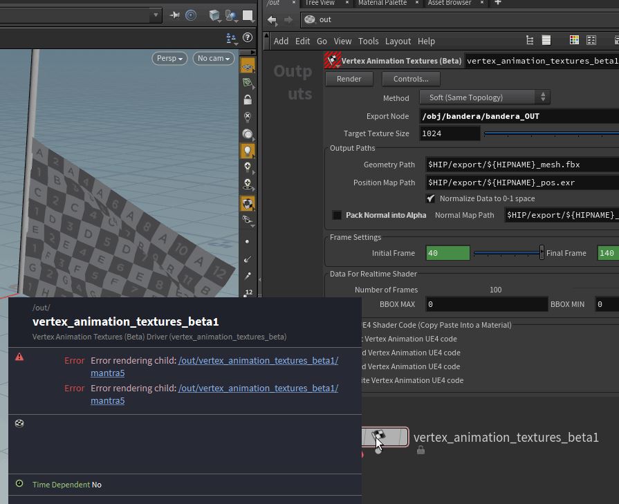

Hi mikelyndon-sesi, I just tried the latest tools, The UVs are OK but it has other problem when I hit render: …..
Edited by apaza610 - July 6, 2017 16:50:55

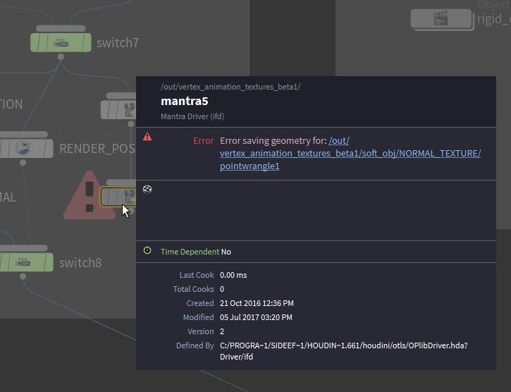

Hmmm. Can you dive inside the rop and see what the error is on the mantra5 node? It should be on the far left inside the container.
Well this is the matra5 node problem…

Strange. I don't know why it's trying to cook those if they're not connected. If you right click on the vertex_animation_textures node and choose “Allow editing of Contents”. Then delete both the mantra4 and mantra5 node as well as NORMAL_TEXTURE inside soft_obj that might fix it. I'll submit an update on GitHub once I've done some more testing.
Thanks Mike, deleting those nodes unfortunatelly does not help I hope you can fix it , I'll be waiting……
