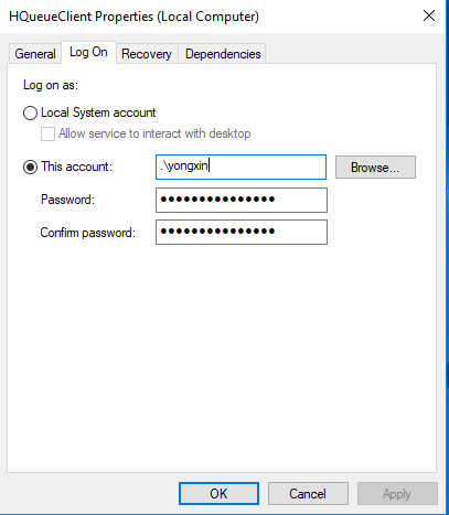

My client can not connect to the server, client service - login,Can only visit the local, can not log on the server.I don't know how to set up. I do not know how to get, who can teach me? thank you very much.

Also, that screenshot shows that you are trying to set the logon account that runs the HQueue Client service. Is an error occurring when you try to change the logon account? If so, what does the error message say?

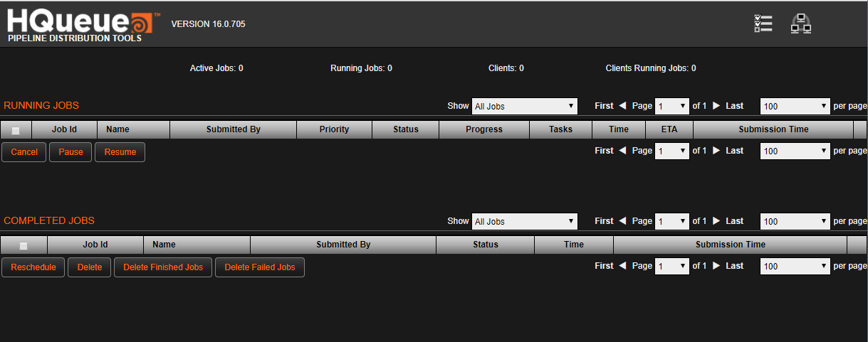

yes,Is the client machine not showing up in the client list on the HQueue website.I think my client is not installed successfully.

Ok. In that case the client machine is probably not pointing to HQueue server machine.
On the client machine, open C:\HQueueClient\hqnode.ini in a text editor. Then look for the line that begins with “server =” and change it so that the server key points to the HQueue server machine.

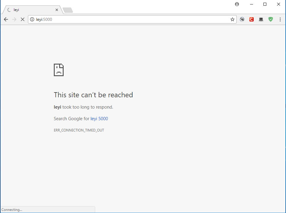

Hmm. If changing the server key in hqnode.ini does not help then it's likely that the client machine does not have network access to the server machine.
For example, from your client machine are you able to “ping leyi” from a Windows command prompt? And are you able to view the HQueue website from the client machine by navigating to "http://leyi:5000" in a web browser?

Yes,I think here is the problem .

If you can't connect to http://leyi:5000 from the client machine then it sounds like either a DNS or firewall networking issue.
Are you able to ping leyi from the client machine?

Yes,But still not connected http:// ip:5000.I can ping the leyi ip from the client machine.I do not know what the problem is?Please help me analyze it,thank you very much.

If you can ping but not connect to port 5000 then it sounds like a firewall issue. If you have any firewalls running on either the server or client machine then you need to poke holes through them to allow incoming and outgoing connections made to port 5000.
