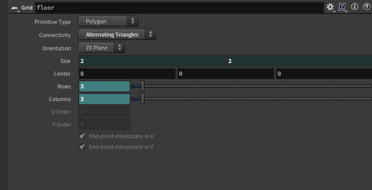

I have a simple grid object and I add a UVTexture node. The UV map seems to be backwards.
Can someone explain why this is, how to fix it, and does it matter?
Here is the grid and the uvtexture properties.
thanks!
1743 posts
Joined: March 2012
Try setting the V scale (the 2nd component of the Scale parameter) on the UV Texture SOP to -1. That seems to reverse it back.
67 posts
Thanks! That works.
