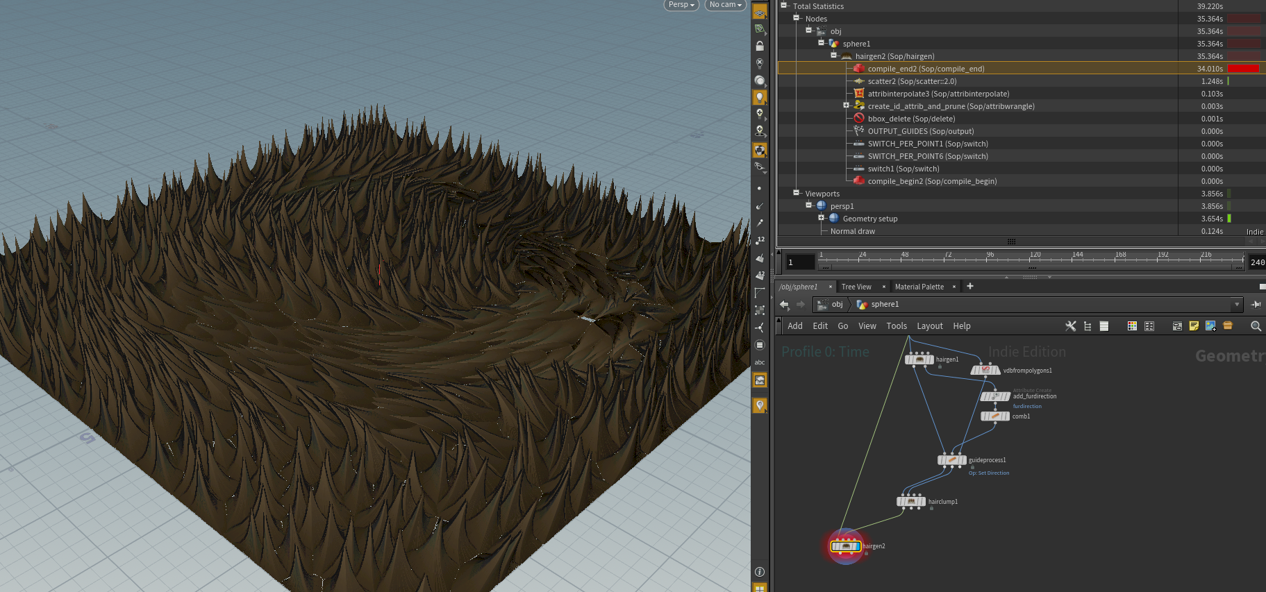

I noticed there is 2 node that take up for 70% of the hair generation part :
the pointwrangle2 (6sec of the 16sec required to generate fur on my machine)
set_animated_point_attribs (4s of the 16s)
ps: disabling the compile block didn't affected the performance.
