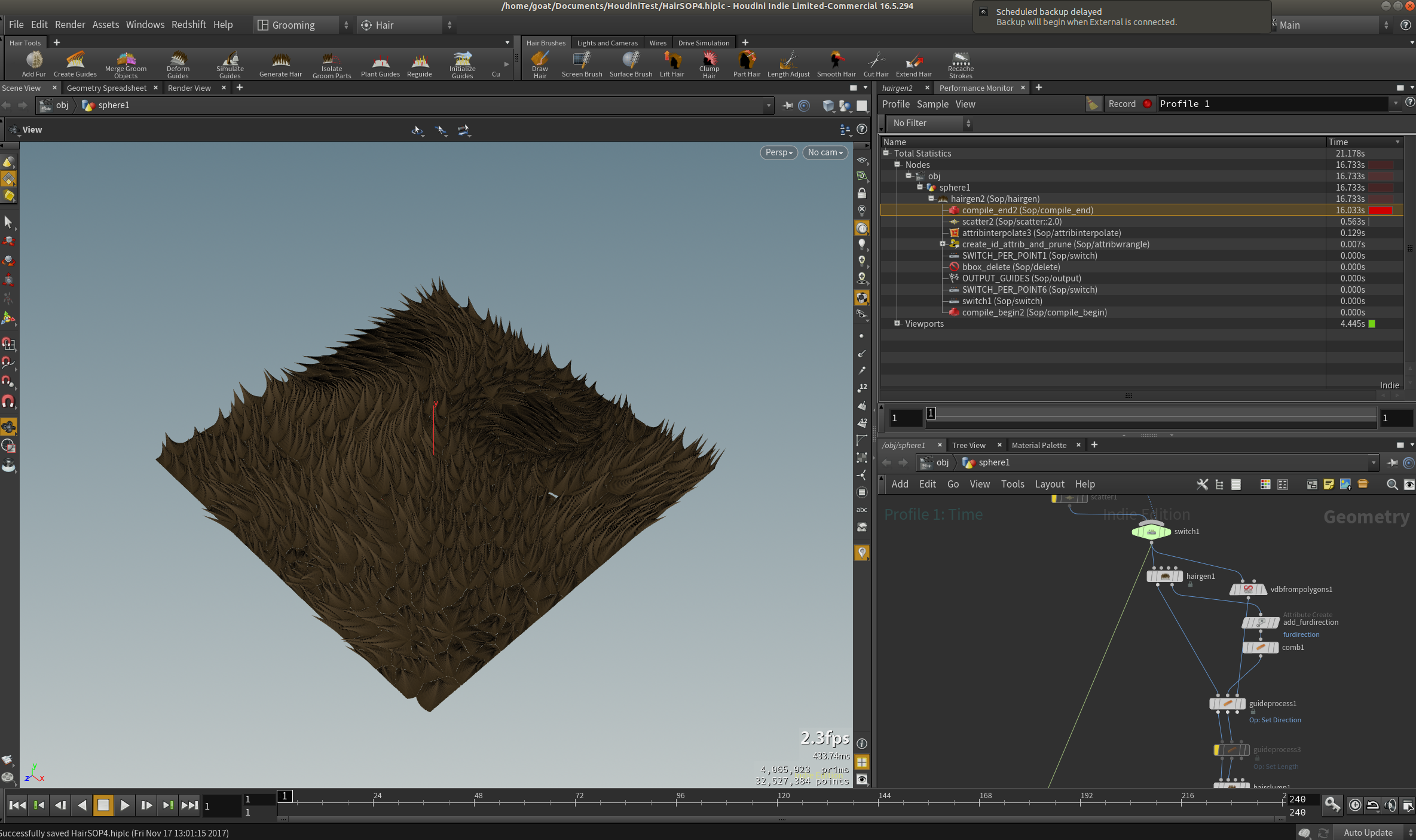

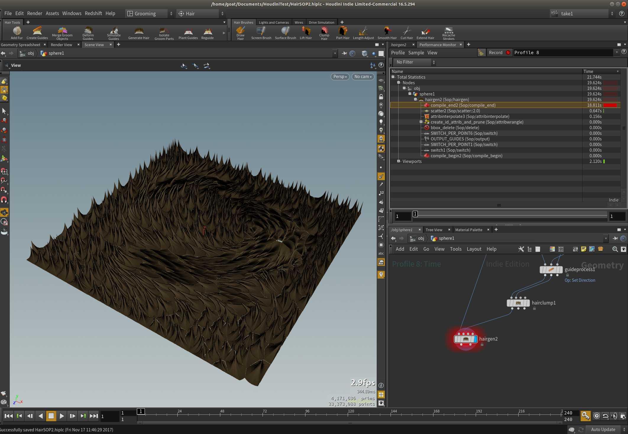

Yeti doesn't actually look any or much better than Houdini with some further testing. Your Houdini fur clumping looks way off as Yeti only clumps guide grooms anyways.
I built a new scene with SOPs hair and for 4mil prims/33mil points it's only 22sec on Ryzen 7 1700.
Reducing down to 10% generation is also very fast at 0.6sec. Just use takes.
The viewport remains the lesser bit at ~6fps when zoomed out but up to 20fps zoomed in, on 1080ti.
See attached.
edit: fwiw more numbers - HairSOP2.hiplc took 23 sec on MacOS 2x X5680 @ 3.33GHz
Edited by anon_user_37409885 - Nov. 17, 2017 15:14:12

Hello, so, I installed ubuntu on my workstation and tried to generate HairSOP2.hiplc
the result are … way better !!!
the very first cook took only 19sec for 4.170.000 fur strand, the second cook took just 15sec !
so, I believe there is some problem with windows ?
I would like to fully switch to linux, but I cannot do it yet, but that is really reassuring to see the problem can be solved.
Also, I'm currently running on 3x8gb 2400mhz cheap RAM, which is probably a big bottleneck for TR right now, I will receive the new flareX 3200mhz Quad channel next month, so I'm pretty sure I will get even better performance on linux, I'll do another test once I receive them !
now, if I can hope to get that good performance on windows, that will be sick !
