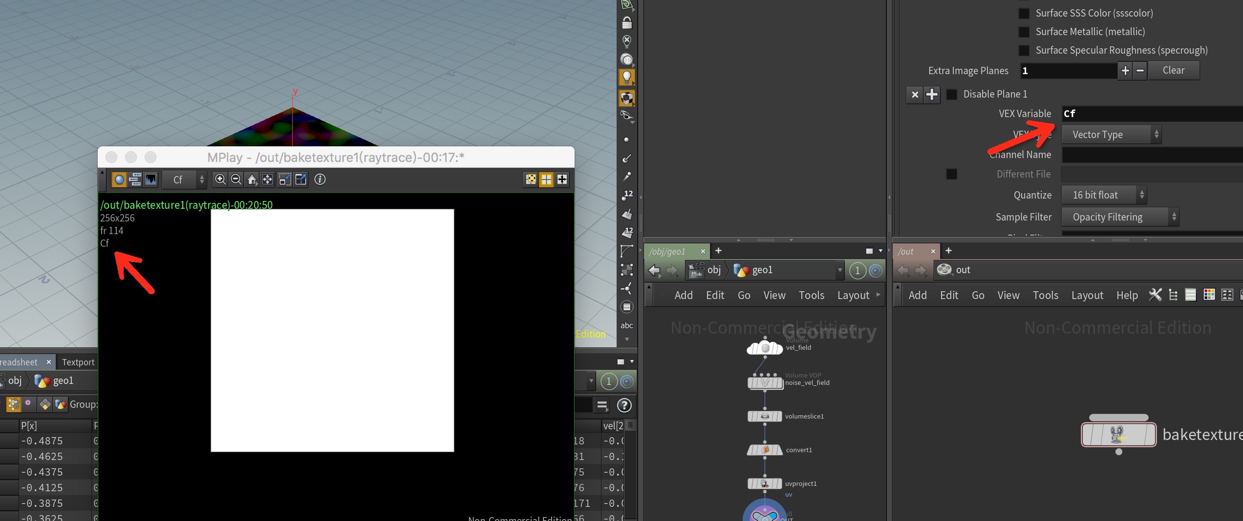

galagastThanks a lot for your helps!I export the texture,it seems not work,may i missing something?

I had a quick look at your file.
Go to Bake Texture > Images > Main and check the ‘color’ image plane.
You have Light Exports set to ‘Merge all light into single channel’
Just set it back to the default ‘No light exports’
Did you set that yourself?
That would not work, because the simple shader I used that generates the ‘color’ plane does not compute lighting.
Hopefully that fixed it.

galagaststill not work….

That is odd.. I opened the file that you attached.
And the only thing I changed was the Light Exports setting I suggested.
Here's a capture of what I did:
As can be seen, I set the Light Exports to the default, then hit Render to MPlay. The results does show the velocity colors baked.
I wonder why it doesn't work on your end. Your file does show that we are using the same version of Houdini.
I attached the new file, could you open this and hit Render to MPlay, then check if you can see the ‘color’ image plane?
H16.5.268 Indie
H16.5.268 Indie

galagastThanks very much! it works! But i confused with this,what is different with color and cf in vex variable channel?and i save to jpg format ,not work.
