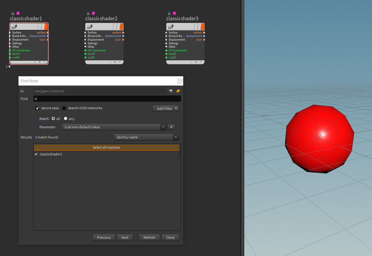

Please, please,please, unlime, ask martinkindl83 where to find it, cause I can't - neither in Preferences nor in D both for network and viewport. Want to play with colours.
Ahh… not sure this is what you're looking for, but in Find Node (/) > you can make this (I've changed color for ClSh1)
(didn't find how to do the same for not linked materials, but maybe you will of will ask rfe):
