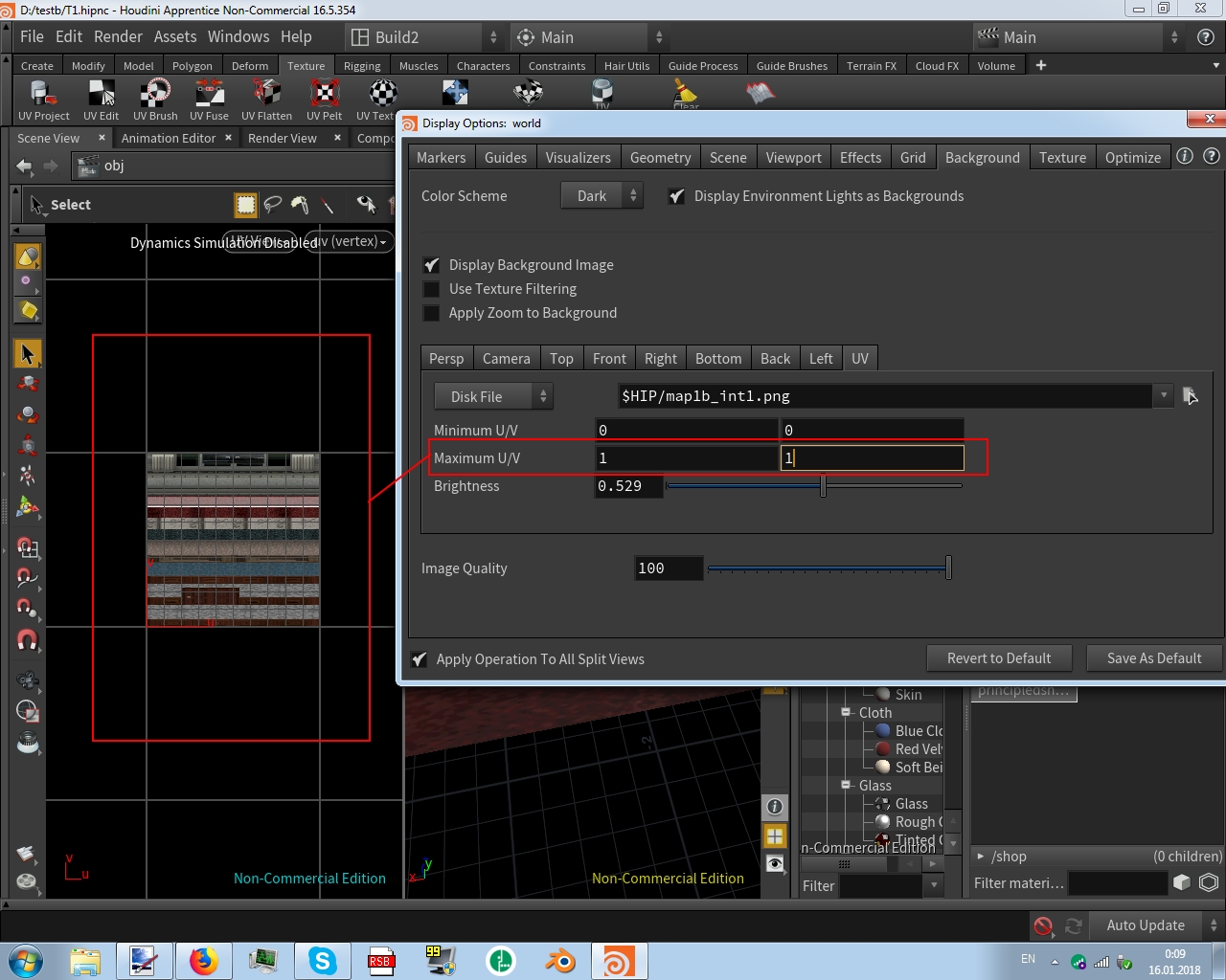

Can I resize the image in Uv View? Now the texture looks strange by default.
57 posts
Joined: Jan. 2018
I understand that these settings affect the size of the tiling, but I can not change them.

So about tiling - it seems to me working (attached gif). Maybe you need to change background from Dark to Light/ Grey to make it visible. Not sure that the question is about it though. Write here/ in the new topic if you've asked about something absolutely different.

I'm going to change this on a light background, because I tried on black and so I do not see any difference in terms of everything. I do not quite understand what these meanings are.
I thought this was the number of repetitions of the image in this form.

I checked these parameters against the background. Nothing changes with me.

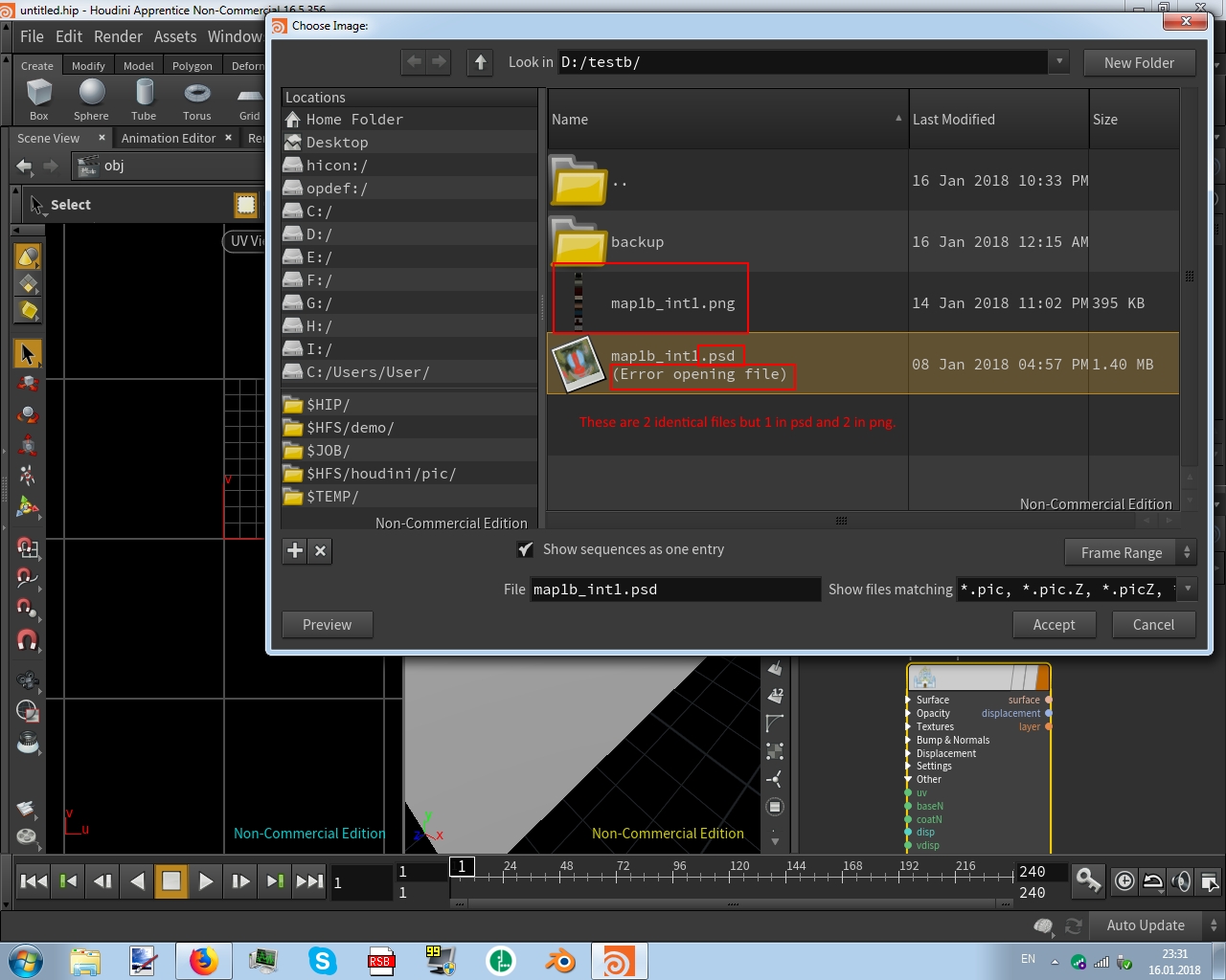

I do not know why psd does not work for me, but those support said that there are no restrictions on the texture formats in the free version.
You have crashes or files are not uploaded?
Do you mean that it's not so as on my gif after you change 1 to 2/ or it is so, but it's not what you was looking for?

1. Houdini 16.5.356 this version no crashed if i set my psd file.Developers have it fixed in it and if the texture is not readable it's just a black screen now.
2 Yes if i change Maximum UV to 2 i no see change as in you video.
See my texture in psd.
map1b_int1.psd (1.4 MB)

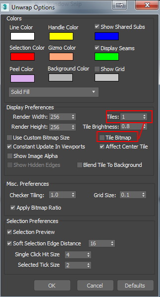

See. 1 screen This my texture no repeat.2 repeat. 3 iN 3DS MAX options for uvw unwrap.
Edited by Ghostil - Jan. 16, 2018 15:57:40
uv tiling in 3ds max.jpg (64.0 KB)
57 posts
Joined: Jan. 2018
It's all about the size of the texture in the form. It shrinks to 512X512 and in fact it is larger.
if in 3ds max true Use custom bitmap size and set Render wight 512 and Render hight 512.
The texture is also drawn not clearly as now in the Houdini by default.

Look. That's what I want to get about. 1 then how now is displayed and 2 as needed if you set for example tiling 3. tiling should be set somewhere in the nuts and the ability to display the real size, too.
5298 posts
There's no option to allow for tiled display of the background image. You could work around it by making a UDIM sequence (image.jpg -> image1001.jpg, 1002, 1003, 1011, 1012, 1013 would give you 3x2) and loading that as the background.

Hey. I tried it like you said. I managed to create another picture on the right. Can you give a link to the description of these parameters? How to use the rest 2? There are 3 tiling parameter uv
5298 posts
I've made it so that the background image will repeat in the UV view in tomorrow's cut (16.5.359). When the min/max values are outside of 0..1 you'll see the background image repeat, rather than black.

The size of the square in which the image is displayed is possible to make that Houdini vystovlyal under the size of the downloaded election? In my example, the height of the picture is larger than the width, but the program automatically sets the quadrant image. The quality of the picture is distorted. All editors give it automatically or in general can load the image size itself

Look in the perspective window that the texture is displayed correctly and it is not compressed. It is necessary that in the uv window it is also displayed, ie the size of 1 cell when loading the image into backgraund should be specified by the size of this image as in all programs.
With the yellow arrow I showed how it should be in 1 cell in uv.
