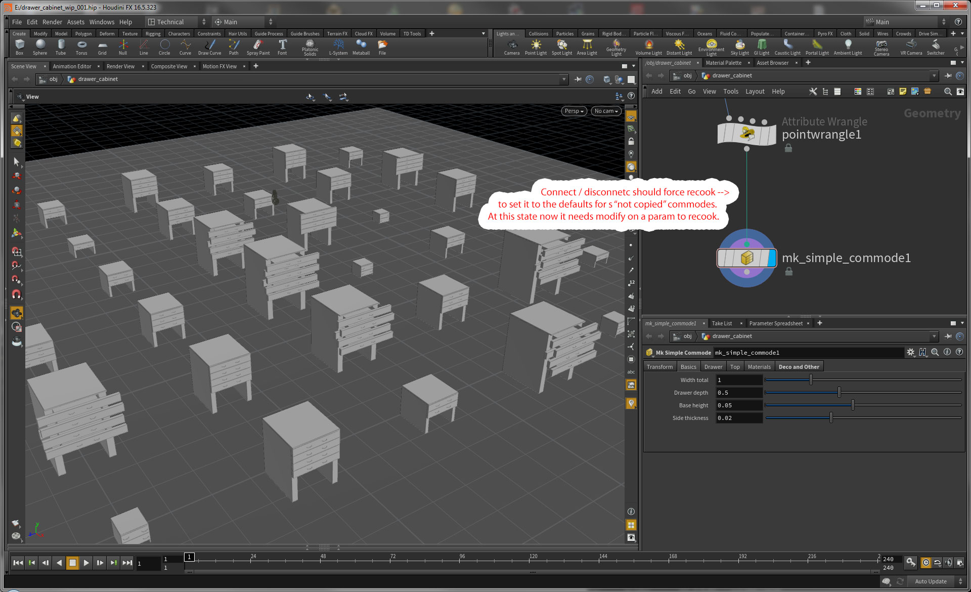

force recook after input change

Changing inputs should always trigger a cook. Only rare circumstances, usually involving solvers/stash would it need to be forced to trigger. You have probably found a bug if a basic sop network fails to recook on input change.
In testing your files, I noticed you using a copy stamp for creating variations. This workflow has been deprecated in favor of compiled blocks with embedded for loops. The problem you are seeing with an apparent lack of recooking, is actually due to the behavior of the stamp expression itself. When you switch cooking to the stamped side of the network (upstream of the node doing the stamping) the value returned by the stamp expression is not the fallback value, but rather the last value to be evaluated by stamping. To fix your problem, you will need to duplicate your network and remove all stamp expressions, or make all stamp expressions conditional on the switch's state at the bottom of the network.
Ideally, you would avoid stamping altogether because it will always be prone to caching issues.
