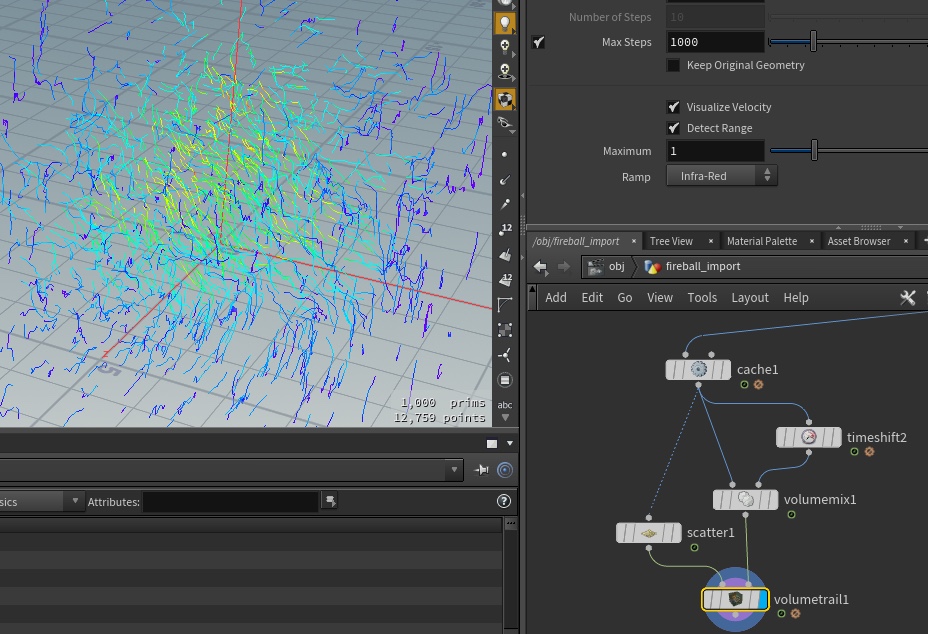

Looks like that should work. Can you confirm that you're getting a working velocity field out of the volumemix by using a scatter and a volume trail?

Thanks for the quick reply, I have attached the pic but it looks like i'm getting the velocity field here:

That trail doesn't look too promising. The lines should be following the velocity field in the volume. Those lines for the most part are just pointing straight up. Is there reason you're using the destination and source premult to blend the volumes instead of the blend parm?
