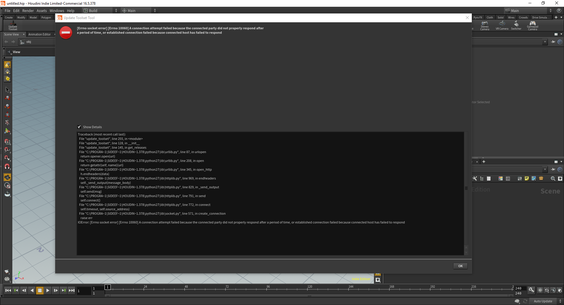

Hi Luiz,
thank you so much for taking the time to walk me through this!
I am starting to think the issue is somewhere on my end.
So i deleted Houdini completely including all folders etc. and reinstalled the new version.
After i tried to download the tools via Houdini using the Update Button.
I have attached a image of the error message i now get.
Sorry, if this is basic stuff :*

Hi Luiz,
i just got home and tried what you said right away!
Major twist - the url was just a http - without the s.
Updating the toolset worked by putting IN the “s” for me!
Then after installing the toolset - its in there without the “s” (just http)
If you try to update again - it wont work again (but tools will still be available when you restart)
Then putting in the “s” again (https) makes it work again!
Could that be the clue? So that in the script its always https (for now)
Because everytime i update it switches back to “http” and then it wont work.
With “https” it works!
Hope this helps!
