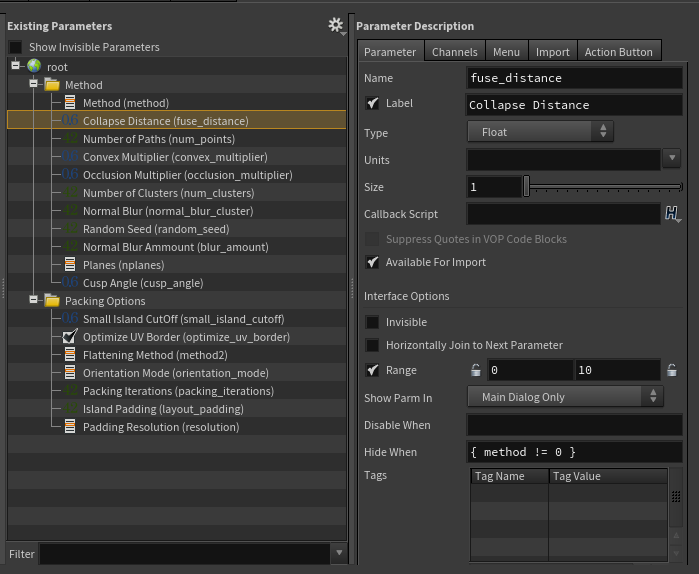

There is a little Hide When in the Type property window that allows you to types in conditions to hide certain parameters for the HDA. The iamge is an example from auto UV sop in Game shelf tools.
