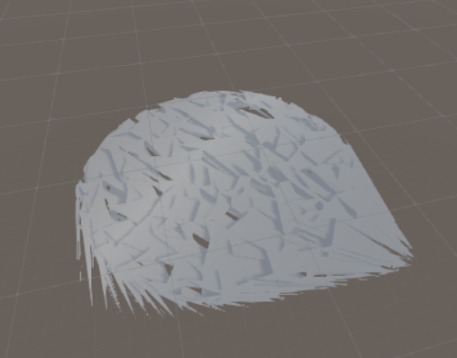

I'm trying to use the vertex animation shader provided in the game dev tools, everything works perfectly in standard PC build but the instant I switch to Universal Windows Platform, everything gets really weird. the animations still happen but the model acts like its trying to animate around a square in the center. In the screenshot I have a “melt object” straight from Houdini that should be completely flat but this is the result. Does anyone have any ideas on how to fix this?

Try turning Export for Mobile option on in the vertex animation texture exporter tool.

Unfortunately, that had the exact same results.

Thanks for attaching the example. Looks like Unity is converting the texture from RGBA Half (16-bit per pixel) to RGBA 32-bit automatically when going from Standard PC build to UWP. The conversion is most likely losing the required data. Try re-exporting from the Vertex Animation Texture tool as TGA instead, with Export for Mobile turned on. Also make sure to set import settings such that power of 2 is none or disabled, wrap mode to repeat, filter mode to point, and compression to None.

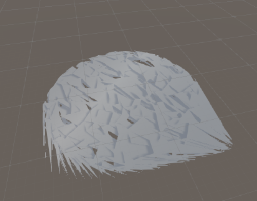

I tried your suggestion and the result was better but it still doesnt look quite right.

571 posts
Joined: May 2017
Attach your textures please.
