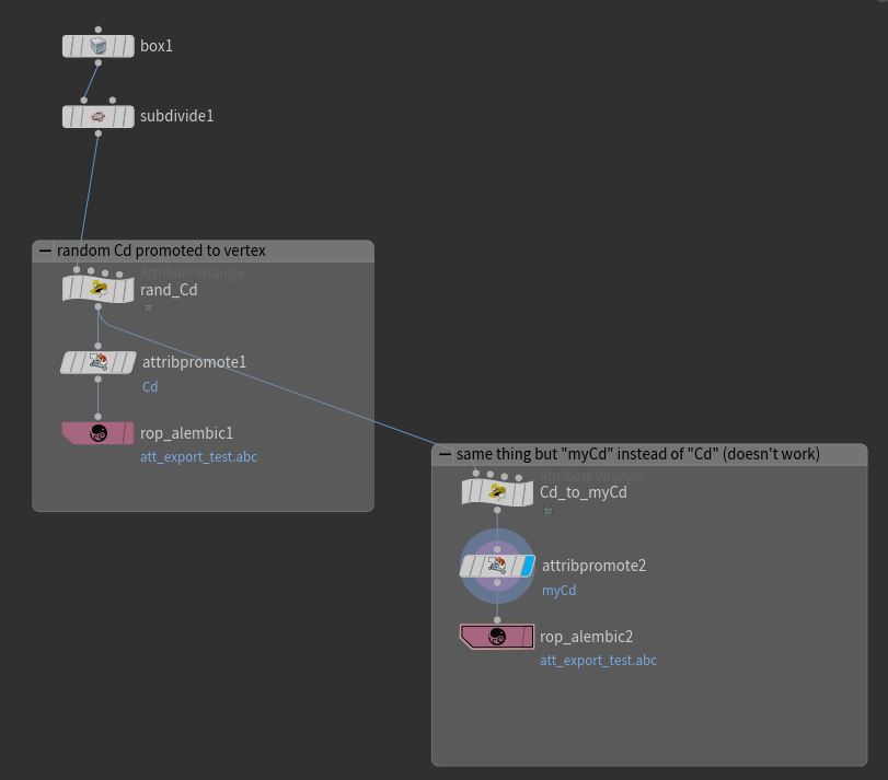

I'm able to export @Cd to maya with alembic but when I try the same thing with @myCd it doesn't show up in Maya.
Anything I'm doing wrong?

The attribute must be type ‘color’ in order for maya to recognize it as a color set. You can set the type to color using an attribute create sop, or with the vex function “setattribtypeinfo.”
http://www.sidefx.com/docs/houdini/vex/functions/setattribtypeinfo.html [www.sidefx.com]
