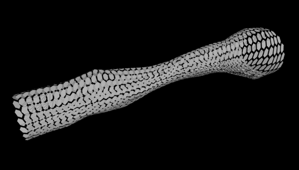

Hello,
I am a student and this is my first post.
I am trying to wrap a grid type geometry around an arm.
This is the mesh I want to be wrapped (1st photo).
The second and third photos is what I am trying to achieve.
How can I achieve this?
Thanks!
Screenshot from 2018-04-24 16-31-20.png (1.2 MB)
Screenshot from 2018-04-24 16-32-50.png (1.9 MB)
Screenshot from 2018-04-24 16-34-16.png (1.7 MB)

have you tried creep sop? I've attached an older example of an hexagon grid posted on this forum few months ago slightly modified.
hexagons_Creep.hipnc (92.8 KB)
732 posts
Joined: Sept. 2013
You can also use
@P = uvsample(1, "P", "uv", @uv);
to wrap geometry around the UVs of another geometry.
hex_to_geo.hipnc (127.6 KB)
