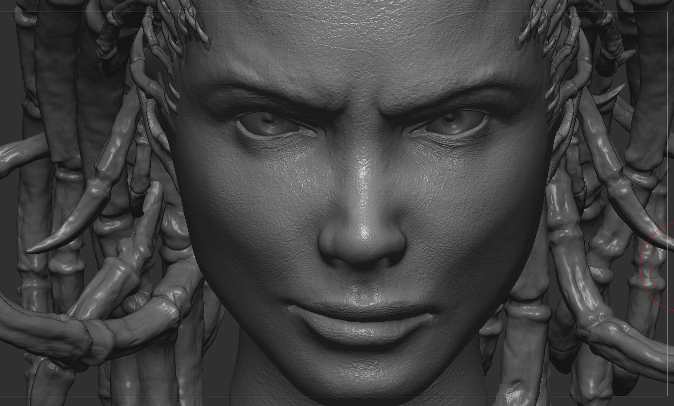

I have hickups when creating hair and will get often error that because not sufficient ammount memory Houdini crash.
When i import my OBJ model in to houdini and do following:
1. Go to Grooming tab
2. Select my model
3. Click on adds fur (this will take about 1-3 minutes to load)
4. I click on “Initialize Guides” and system crashes.
As i understand it is because 16 gigs of ram is no good for this job.
But as i am trying only to add facial hair (so not many hair strings but more like some scattered along the face)
Like you see on this model face
https://i.imgur.com/7vy2w6p.jpg [i.imgur.com]
The model i have is this one:
https://www.artstation.com/artwork/RvGdm [www.artstation.com]
Is there a way to add sting less of those hairs so system wont crash. (as has to calculate less)
What method would you suggest?
fiber-mesh in Zbrush and then somehow to convert it in Houdini to facial hair? (how?)
I am trying to find a ways to do facial hair without buyng more ram (as i cant afford it at the moment)
