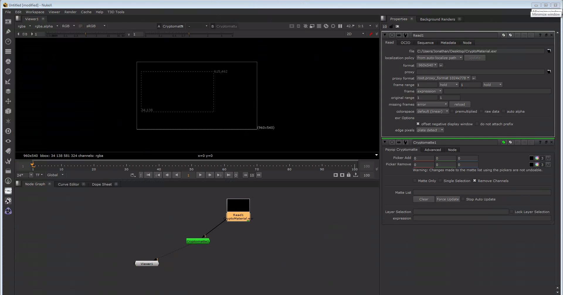

I am not doing anything special. Just rendering out a normal exr and the cryptomatte pass is being rendered separately. I have no special options enabled….just a normal render using the object pass under cryptomatte (no special attributes). I even tried a brand new scene with a simple camera; 2 objects; a light; and mantra pbr node. Still get the same results. I also tried to open up the cryptomatte node in the composite view and it's not working there either. However, you can see the matte in cops but it's not working at all. Please see the references below. I'd be happy to create a new simple scene with 2 objects, etc. and attach the file here if needed. I am wondering if it's a bug with the particular build: 16.5.439?? Any suggestions?

Do the object names show up in Cryptomatte COP's “Matte Selection” parameter box when you select the objects you want to generate matte for? (it's difficult to tell from screenshots if you have anything selected)
Also, I noticed from your Nuke screenshot that you're using an old version of cryptomatte plugin - it shouldn't matter as long as it's relatively recent, but can you try using the latest plugin and see if anything changes?

I have attached the .hip file I was testing with. I did upgrade the cyrptomatte node in nuke and that partially fixed the problem. When I render out the cryptomatte exr as a separate file, it now shows up correctly in nuke. However, if I do not render the cryptomatte file separately, then the mantra exr render immediately errors when dropped into Nuke. Any suggestions?
