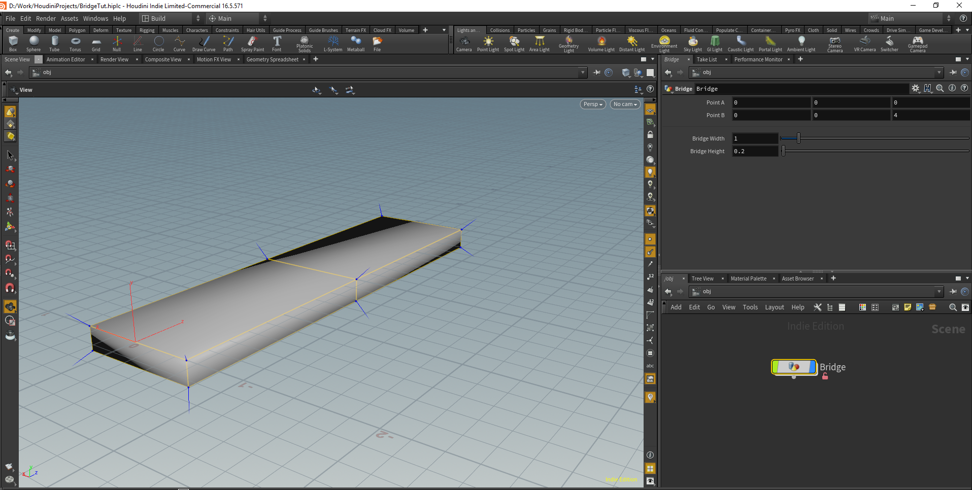

Looks like you moved your Tut_bridge.hdalc from under HoudiniProjects/HoudiniTests/ to its parent directory HoudiniProjects?
And the actual problem is that you need to change Asset Path, not Asset Cache Folder Path. You changed the wrong field.
I'll make this easier in the future via a file select UI, instead of manually entering the field.

So that is just Unity's warning that the file is outside the project and therefore not recommended to be loaded via the AssetDatabase. Its harmless and wouldn't cause any issues to the rest of the Houdini Engine functionality. If you want to get rid of the warning, then simply move the HDA file to inside your Unity project's Asset folder and reinstantiate by dragging & dropping the HDA file into the scene or load from menu.
As an aside, I should probably check if the file is outside the project and not bother trying to load through the AssetDatabase as its unnecessary.
Back to your issue, looks like your asset loaded fine, and generated an output which is the polyextrude1_0 gameobject. Are you expecting something else?
