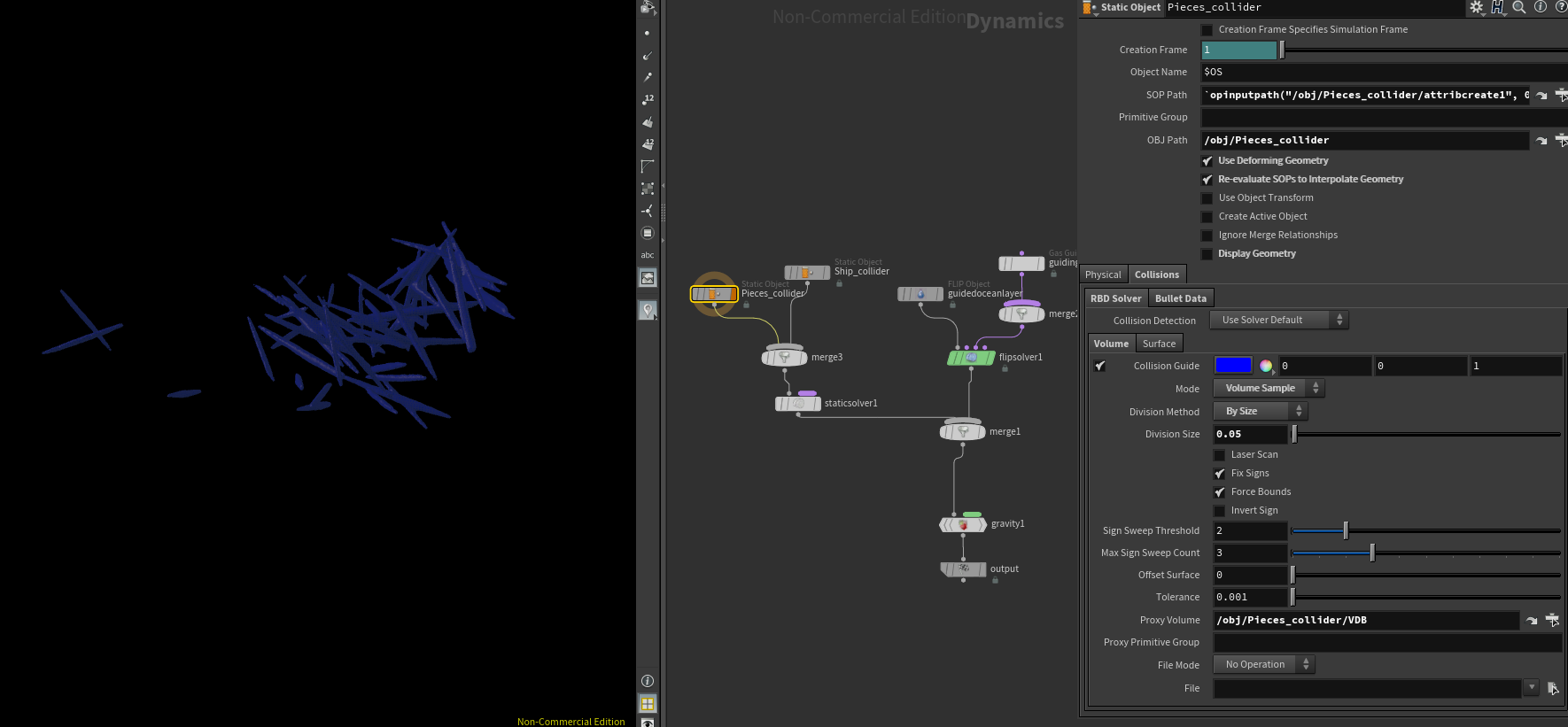

I'm trying to use some proxy pieces to collide with a FLIP simulation but can't get them to work properly, they create artifacts when using them as a group. The pieces already have a vdb collision, have velocity computed and work well when using them individually but there is some problem when trying to use them at once.
The collision guide in the FLIP object node doesn't show any collision but they work so don't know if that's the problem, also just in case I have the bullet setup as convex hull with the create per set or primitives activated and nothing.
I'm attaching a video with 3 different setups, with all the pieces, with 3 and with 1 and 2 screenshots of the pieces setup. If anyone has any idea or has encountered this error would be great to get some help.

Finally fixed it, in case anyone has this problem. In my case, the problem wasn't about collision geometry, the velocity on the colliders was incorrect, if you compute the velocity of a collision geometry after deleting any point it creates velocity spikes, just compute the velocity before modifying the geometry. Using a single mesh was fixing it because there were just one geometry so the velocities were correct.
