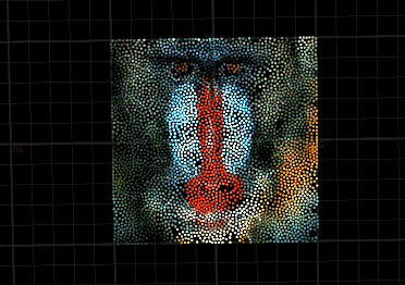

Here's one of many ways.
Next to the popnet is a little example of a hacked together colour keyer inspired from reading this page [vfxtheory.blogspot.com]. Take the colour of each pixel (or particle), and plot that colour so that rgb becomes xyz. Then take the colour you want to use as your main colour, say a bright blue, also plot that in 3d space.
If you measure the distance between those two points, and only keep the points that are within a certain distance, then thats a basic colour keyer.
Using that idea, inside the popnet I have a few forces, and each uses the same colour keyer maths to only allow that force to affect particles with a certain colour. So red particles are moved along z, blue particles along x, and green particles are spun in a circle.
After that are a few more forces that work on all particles equally, here a pop interact so the particles repel each other a little, and a noise to give a general noisy behaviour.
