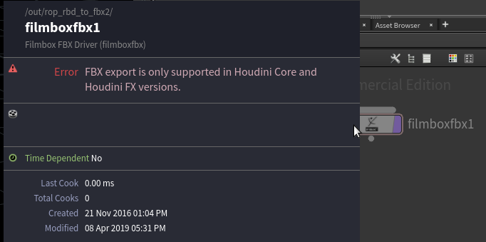

hey.!
just took a look at your file. I can't see your error, but seeing this error (attached) due to no fbx support in the nc version of houdini.
Can you upload a .hip instead, unless this is the problem etc.
cheers
ben
