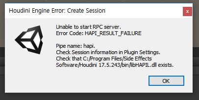

After using for a while and without any issues Houdini Engine + Unity, Houdini Engine suddently stopped working.
Here is the error message I get :
I verified the presence of this .dll file, and everything seems to be normal.

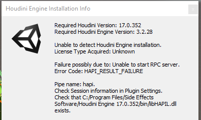

Here is what I get when opening the Installation Info dialog :
And here is the session information (everything is still the default settings):
I verified my firewall settings and houdini is not being blocked.
This issue shows up even in an empty Unity project, with only the Houdini engine files added.
Any idea of what have could gone wrong?

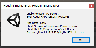

It is exactly what happens to me. I have same issue. My houdini version 17.5.229.
All I tried was failed and It is still stacked.

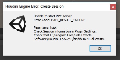

After installing the latest version(17.5.243), I tried to run it as it did, but I get the following error:
I had this error in the previous run, and I checked the libHAPIL.dll file every time. This file did not have any problems.
I tried closing all the session and create a new session, too. but, It still doesn't work.

The panel message appeared. I got the same panel by going to HoudiniEngine > Installation Info. I also attached the Plugin Settings which I haven't really touched from the defaults (I don't think at least). I also included the SessionInfo from HoudiniEngine > Session > SessionInfo.
