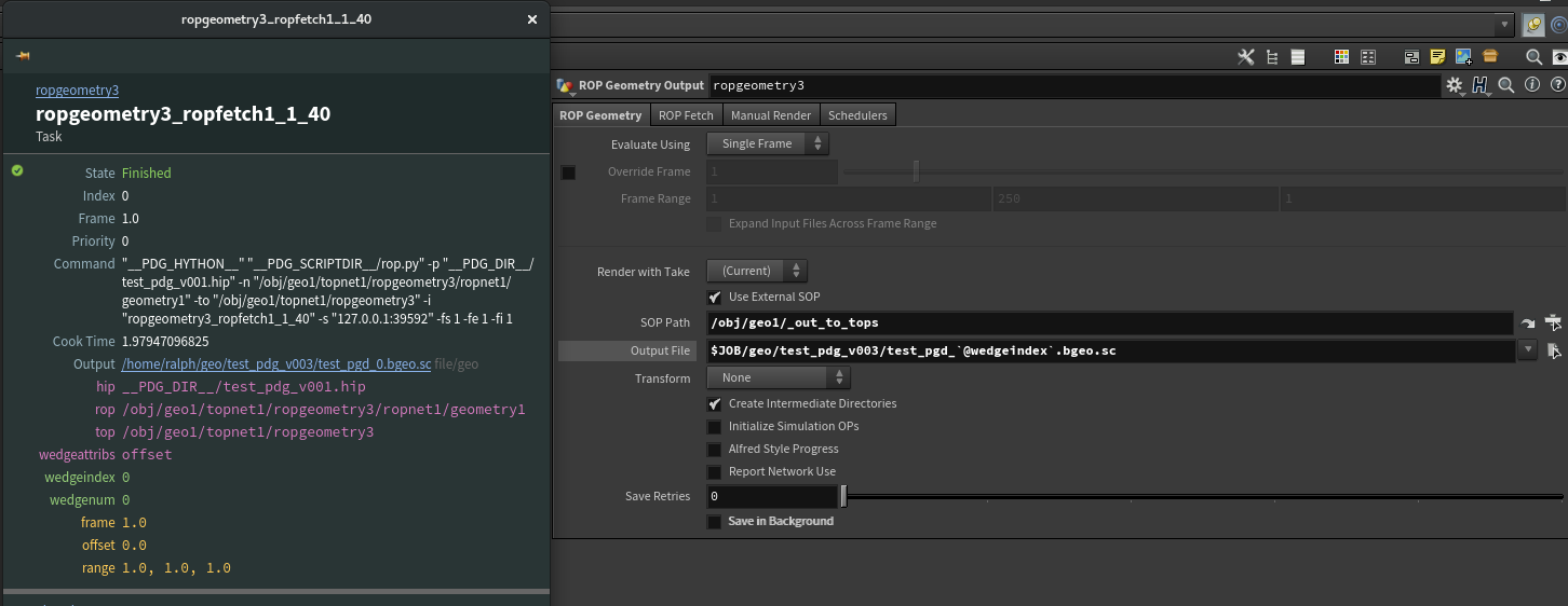

This is the first time I'm playing with PDG so this might be a user error but I'm having issues with the ropgeometry. It seems to correctly generate all the wedges if I set an absolute path, but when I use the $JOB or $HIP variable it seems the output variable doesn't evaluate properly. The expected outputpath is correct but the final path is not. It will write to my default home folder. Is there something that I'm doing wrong?

$HIP should work fine - that's what all of the example files use, and what the default value contains. There was bug with $JOB being overwritten incorrectly by the job script that evaluates the ROP, though. That issue will be fixed in tomorrow's daily build.
