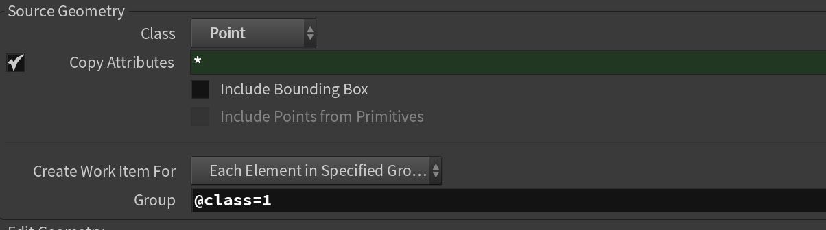

I noticed that in a geometry import node it's not possible to dynamically define a group with the @attribute=value notation.
Is there any reason for that?
It's not a big deal of course, but sometimes you just don't want to create more groups :p
cheers

You mean the warning you get?
using i@class=1 instead removes the warning.
But I have no clue about Tops…so I don't know if this is the issue.
626 posts
Joined: May 2014
It's currently not possible to create adhoc groups that way using the geometry import node. Work items can only be created from groups that already exist in the source geometry.
