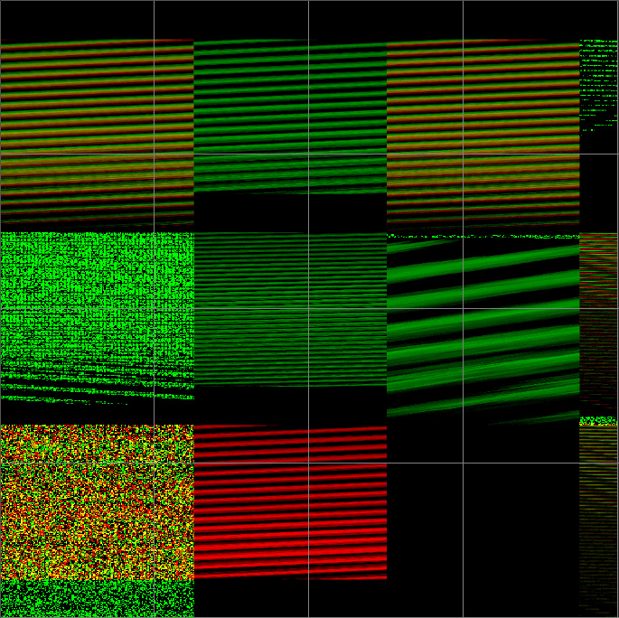

Going to hijack my own thread as I am seemingly having endless problems with the simplest things. I recently made a new pyro simulation, cached it all out, and then ran the texture sheet rop again. And while it actually does work in that it will render out sheets for me, the packed texture sheet comes out looking like abstract art… any idea why this is?
broken sheet.jpg (403.7 KB)

Can you upload a hip file?

Hope this isn't thread necromancy, but I wanted to update with how the problem was resolved, for people who have a similar problem with the texture sheet rop not behaving.
It turns out that because my sim was starting at a frame other than 0, it was causing the rop to wig out and not behave. a timeshift node fixed that problem, thanks Mike, and houdini support people
