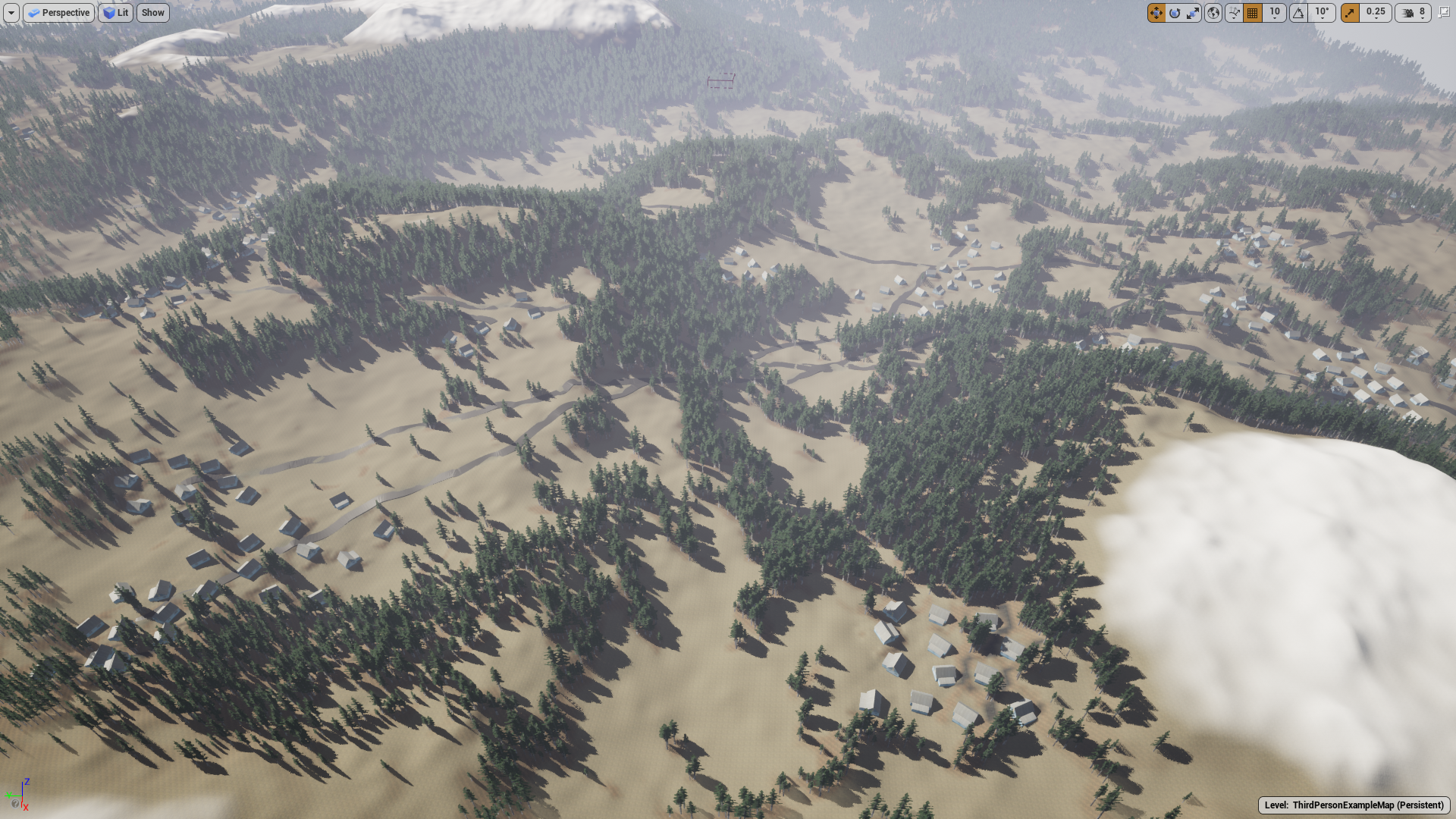

Update (4.3), now it place happy little villages and flat the gound under houses
- Terrain scale is now 1/1
Update (4.3)
It make a simple road mesh

Yesterday i added towns with buildings, and made the terrain look better.

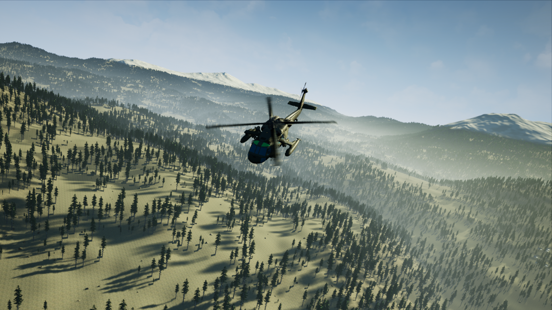

Last small update, ground is flatten under houses, 2k terrain resolution
Edited by samuelbrunner - Aug. 12, 2019 18:35:36
uh-60 fly.png (2.7 MB)
