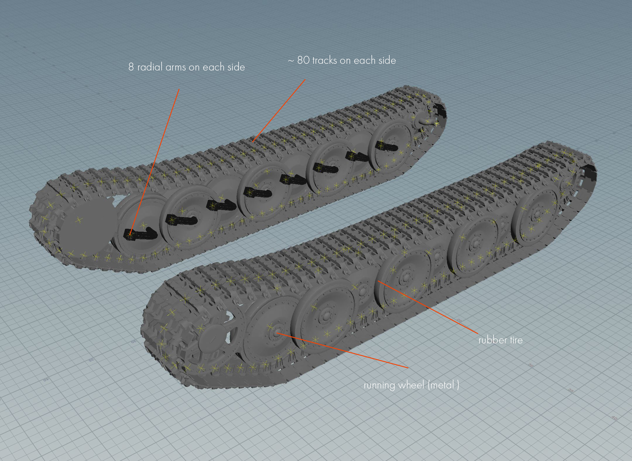

A long time ago I've created a very complex tank model within SI, which I recently imported in Houdini and which I would love to animate someday.
The problem that I face now is that I need to group or combine certain components such as running wheels or rubber tyres in order to create one UV Layout that could simplify subsequent texturing in Substance Painter (cue: UDIM tiles)
Since every wheel needs to have its own independent radial arm, I can't find a way to create one combined UV Layout for all running wheels, tires, tracks without changing the hierarchy. I guess can't merge the components (and assign one UV Layout) and break them apart later on, because they won't propably keep their original position as soon as I reassign/parent them to their particular radial arm null.
Is there maybe a way to group all moving objects (wheels, tires etc.) without merging them and assign a UV Layout to the this particular group?
If not, what would you do, if you had to texture hundreds of more or less identical objects that all are supposed to have individual textures made with Substance Painter?
It wouldn't be a problem at all, if they were static objects, but since they will rotate or move later on, I think I can't just merge them.
Any ideas would be highly appreciated! Thanks for your help & time & best regards
