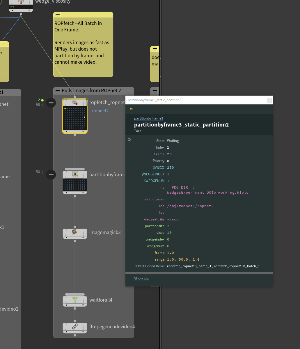

The ROPfetch at All Frames in One Batch renders the images fine, but all dots except for two are grayed out with state “Waiting. The Two that are green, state ”Cooking“.
The PartitionByFrame is stuck in perpetual state ”Waiting".
PDG Issue2.PNG (105.2 KB)

I had some errors when loading the .hip about missing assets, so I didn't try to cook it - I only generated the graph to verify the partitioner was working.
The problem is that you're pointing the ROP Fetch nodes to ROP Networks instead of a specific ROP. When cooking a batch, PDG needs to be alerted when each frame in the batch completes. It does that by hooking into the target ROP's pre/post frame callbacks, which the ROP Network itself doesn't have. If you change your ropfetch to point directly to the GL rop it should work as you expect.

wow, pointing it to the OpenGL ROP as you suggested works and partitions fine now. For some reason I was getting errors before, (can't remember exactly–something about cannot find opengl rop)
In any case, thank you for helping! I believe the problem is solved. For anyone interested, the attached file generates flipbook quality previews for sims (just point the ROPfetch to the opengl rop).
