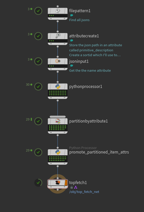

Ah, ok, I understand better. So, we basically need to launch as many for loops as there are sortids. The way to do this is via the topfetch feature, which allows a separate top network to be launched per workitem. I put the for-loop in that separate top network (top_fetch_net). In the for loop, we generate the number of iterations based on the ‘partitionsize’ attribute, which is inherited from the partition. Finally, notice there is the promote_partitioned_item_attrs node immediately above the topfetch. This is so we can promote whatever attributes you need from the partitioned items to the top level, so it is accessible in the for loop. In this case, I aggregated the names of the characters onto the ‘upstream_names’ attribute.

Thanks for your patience Ken, this does what I need !

Yes I think the top fetch is a good workflow for my case. It is just the way you have to combine your partition's work item attributes to then uncombine them manually in the fetch which seems a bit of a hack :p
