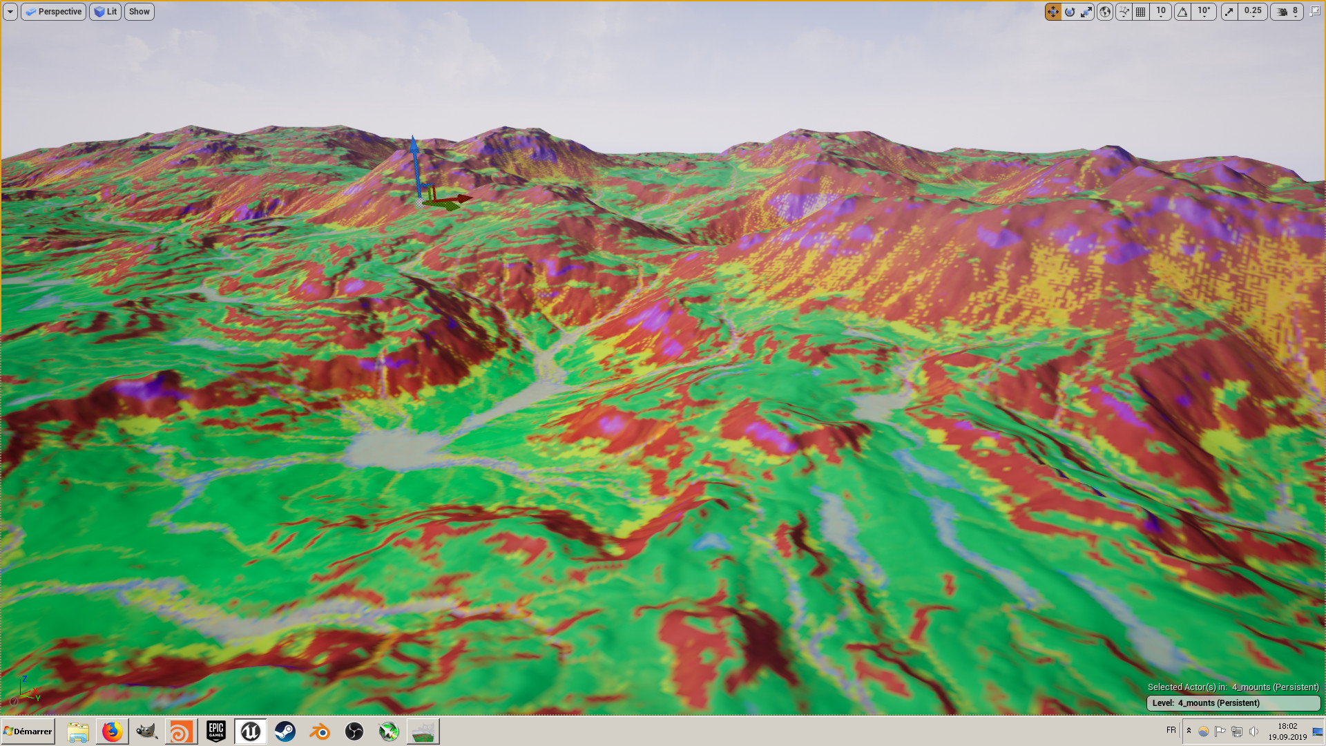

Hello,
I just found how to see erosion mask in UE, its pretty simple in fact but took me 1 month to figure out how to be able to see them properly
You can see there is still a issue with watermask, not showing completly in UE…

I was also struggling with masks. Remapping it solved my problem!
Thank you man!

Hello,
The problem only appear for me if i set erosion time under 20.
But there is another issue i ran into
If i use hf layer for masks, it get mess up : Image 1-2 with hf layer, image 3-4 without hf layer
